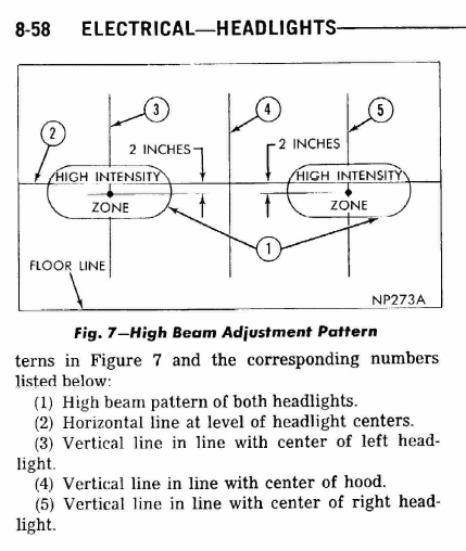

I got good results (good, not great) by going with "OEM" halogen replacements. I then carefully adjusted them per the FSM using a parking garage wall and masking tape to make the necessary marks. I also replaced the headlight and high-beam switches, inspected and cleaned all connections, etc.
When I say "good", I mean "much better than it was and I can see the road at night".
Also, have a look at this thread: 1970 Cjhrysler 300 Headlights - Change to Halogen
From the FSM:

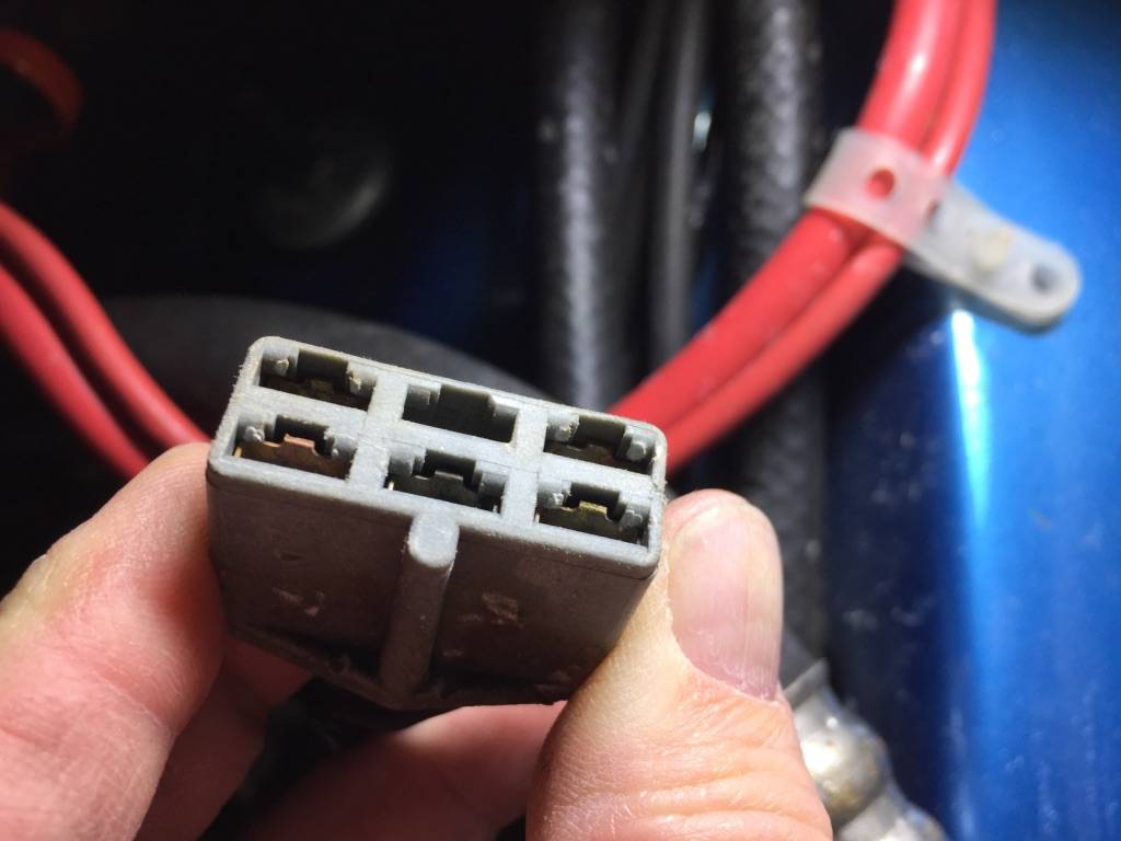

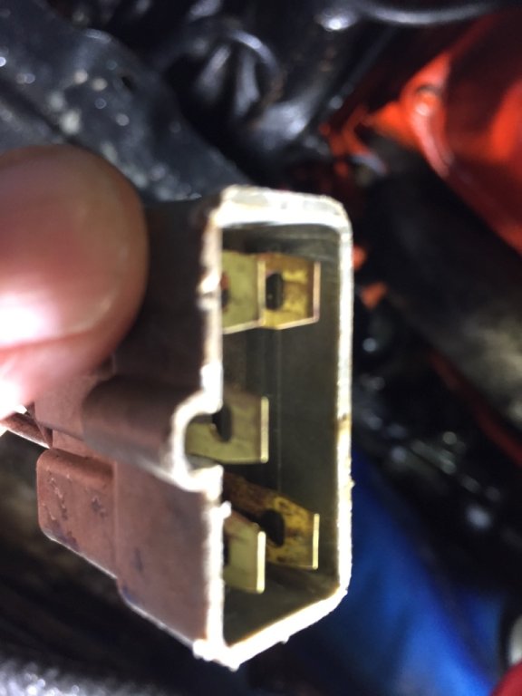

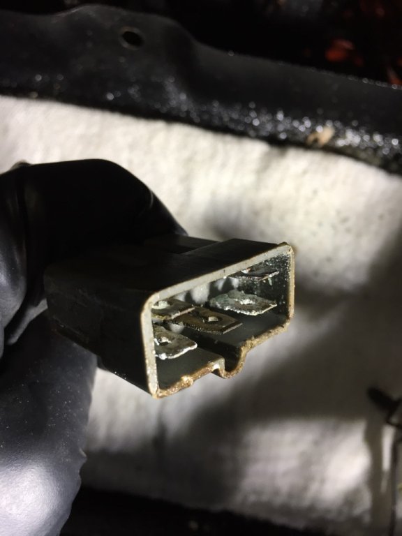

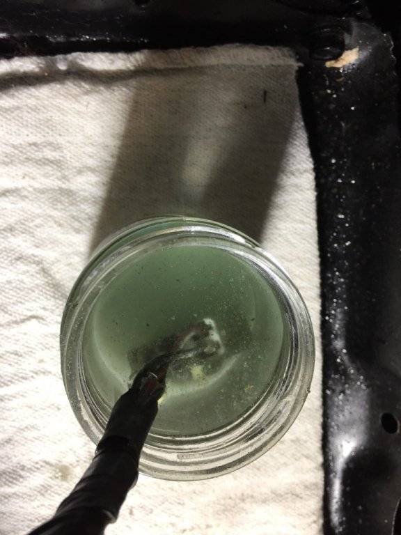

Relay option, also clean every power and ground connection in the harness to your lighting system. Do all the electrical connections while your at it, it will only help. Small wire brush, vinegar and salt mix soak, scrub and rinse with contact cleaner, then apply some corrosion preventer like dielectric grease. I'll use some Fluid Film on my connections after clean up.
Absolutely good advice. I did exactly the same with every connection in my car. :BangHead: Despite @Big_John 's misgivings on the use, I pack every connection with dielectric grease because that's what it's made for, just like Noalox is used on aluminum house wiring at the fuse panel. The grease doesn't improve a good, clean connection but it does KEEP it corrosion-free for the next 50 years.
Dielectric grease is available everywhere. Depot, auto chains, Amazon....
Oh....and the firewall bulkhead connections are probably the worst problem spot. An annoying hour or two cleaning those big connectors is time well spent.

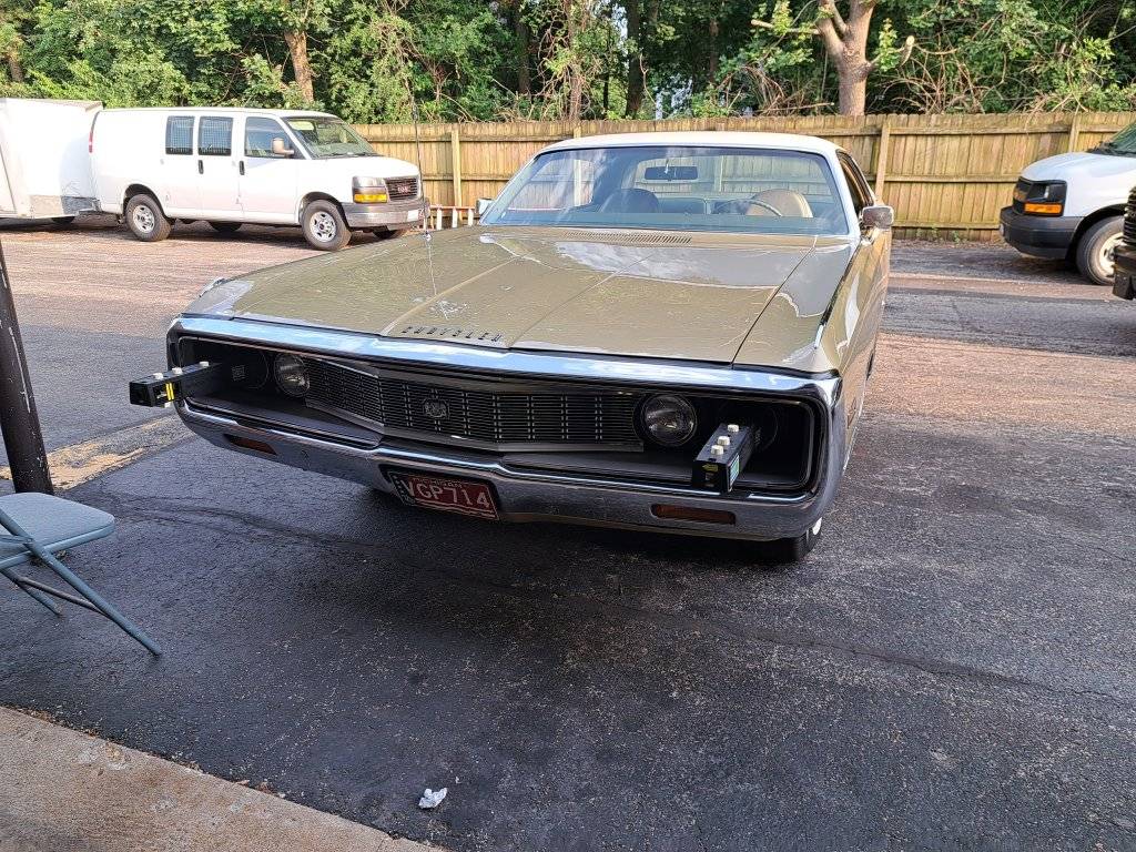

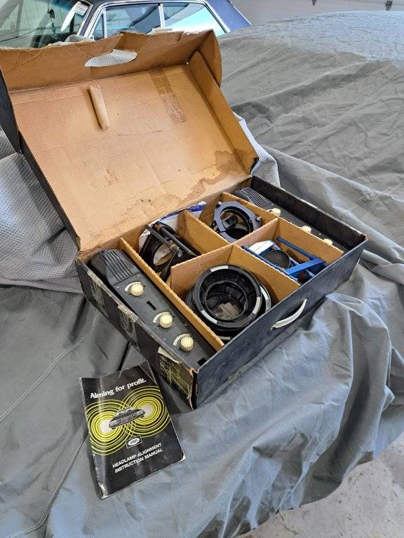

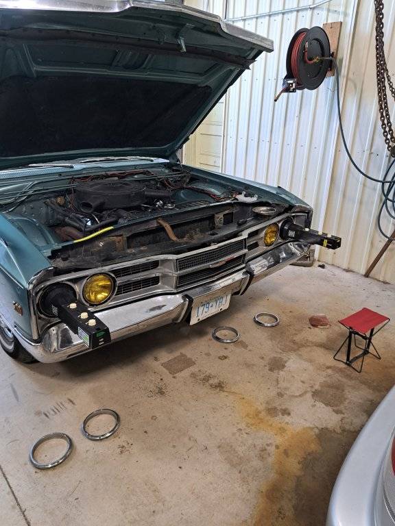

I have the old school Hoppy headlight alignment kit...
I did @sixpkrt award winning NYer, and did all my C's at home. Works great and makes a huge difference!
Especially when the cars were torn apart during a resto and the headlights are out of whack.
LOTS on eBay.
There are a few on eBay. Prices vary over a wide range. Very tempting to get one, though I've done well with a block wall, black tape, tape measures and carefully following instructions printed on my 50+ yr old Westinghouse 4001 boxes.... Good electrical wiring, contacts et al make an impressive difference, to be sure.
I think I will seriously look into getting a kit. Nice to offer clients after doing a job for them.
View attachment 669524View attachment 669525View attachment 669526View attachment 669527View attachment 669528
That cleaned up great

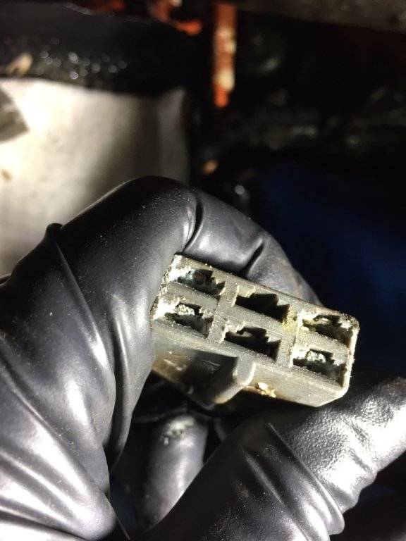

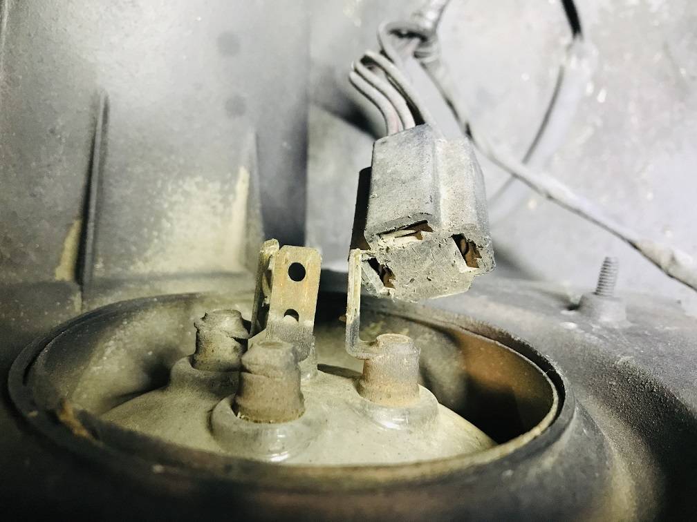

I didn't realize I'd get so many good posts. Thanks for all the help. I'll post the difference once I get into it. I took a quick pic. I'll clean them as you guys said but I don't think it looks too bad for 54yrs old.

One of the dirtiest headlight plugs I've ever seen. No wonder the lights are dim. It looks like they're full of over-spray.
