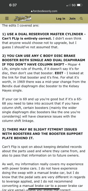

What makes you think you can use a drum brake booster? From my research, disc brakes need twice as much boost as do drum brakes. Hence the dual diaphragm.
Of course I’ll be looking for a disc booster and yes to the dual diaphragm. Thanks
Maybe I read this wrong but below shows which boosters I can use based on a post from this site. I have a center console shift car not column shift .

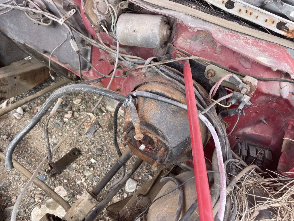

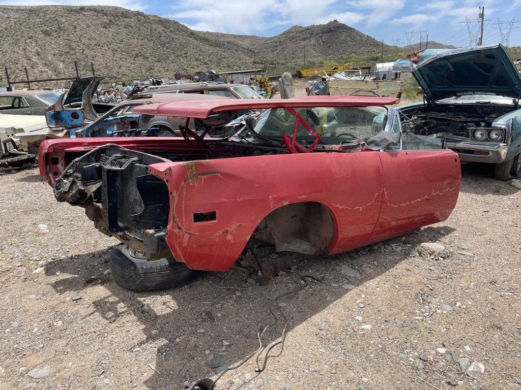

Don’t go through the trouble. I’ve just purchased the power disc booster from the 69 polara parts car I bought my disc brakes from. Thanks anyways.

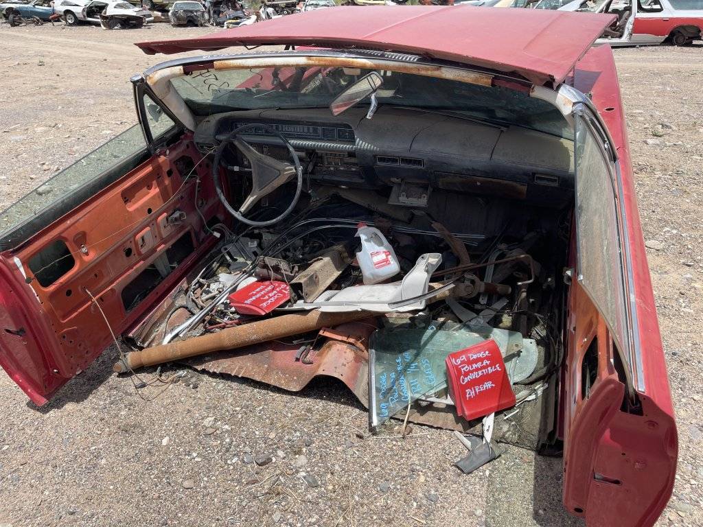

I pulled the spindles, rotors, calipers, dust shields, and prop valve from a parts car 69 dodge polara that had power brakes.
See below.
I will be grabbing the donor cars brake disc power booster as well. I already have a nice disc drum 4 bolt MC with 1 , 1/8 bore thanks to mobile parts.
You may want to have that booster rebuilt before installing it in your car. If it still works, it probably won't for long without refreshing. You will also need to grab the brake pedal linkage from under the dash.
