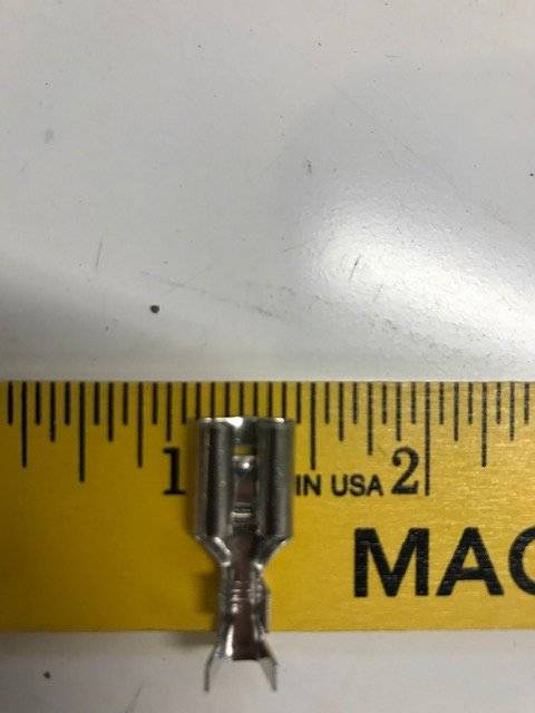

I added relay's to my head lights, which require some splicing into my original plugs. I am looking for the style or name of the original terminals. ( Fit H4 yes I have searched that). I bought some off e-bay that were advertised as 3/8' locking terminals. They even showed a picture on a ruler. Problem is they were offset (which I missed) and were actually 7/16 wide.
Does anyone actually have a source or a name for the proper head light terminal plugs? I guess the modern version of which they call 3/8 are a poor metric conversion.

Original 3/8"

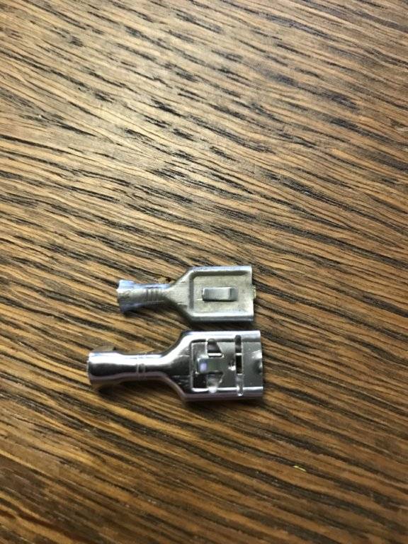

Advertized 3/8" actually 7/16" which will not fit the socktes

Packard 56 connectors. 5/16 wide.
The male side of the terminal determines the width of the terminal.
The new one does have a lock.
Which I need to insert into the plug.

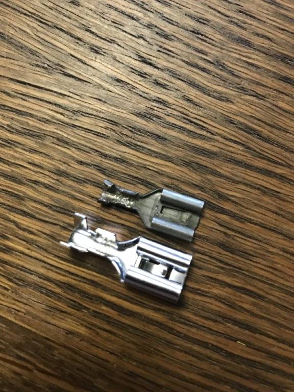

Original on top
Thanks @Big_John , that is likely my problem. I only measured the side I needed.

Well finally after 19 days I finally got the right female terminals. I learned a lot about terminals and now have about 25 - 3/8 terminals. Too big. And then I ordered off the link above, 1/4” too small. The Packard 56 are the style used for most of the terminals in the car but are 1/4”. Packard 56 =1/4”.
Sooo. I found some Packard 59 female terminals. Packard 59 = 5/16”. Perfect.
So if you are replacing head light sockets the Packard 59 are the ones needed. You can get them in two different wire sizes. 14-18 gauge or 10-12 gauge which are also used for dual wires for each plug which most 4 light headlight systems do. At least in ‘68.
