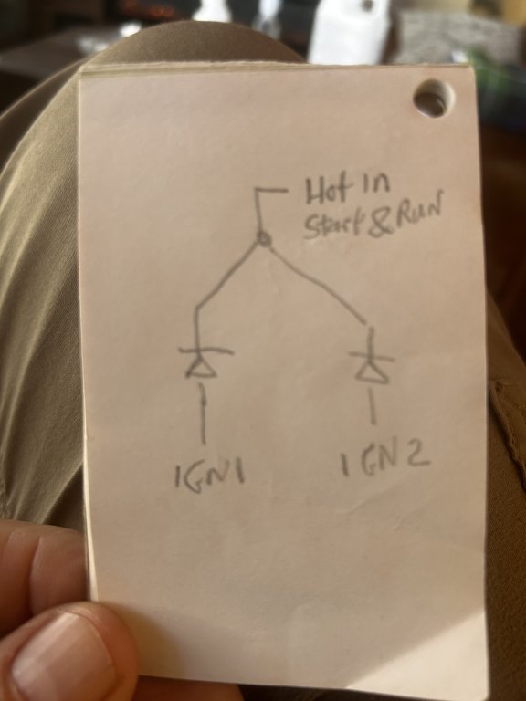

You should be able to tie both ign1 and 2 together.
However, if you want, you could run a wire from each through a diode to produce the signal that you are looking for.
Kinda like this:
