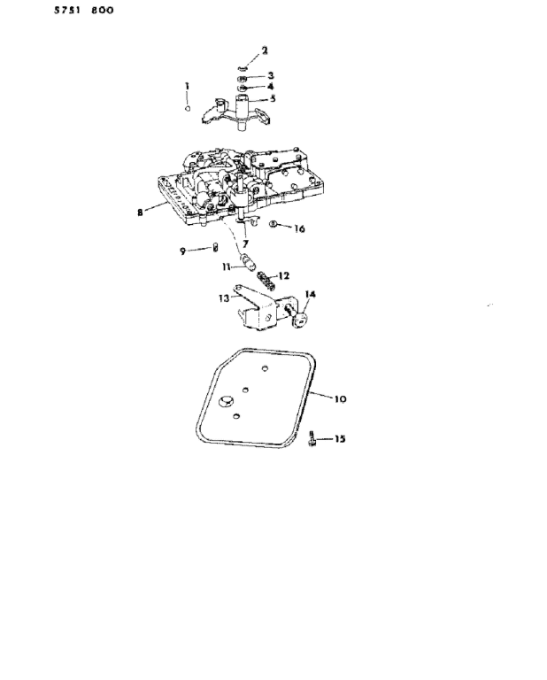

It is the same seal used on later Torqueflites. Rather than seal to the valve body shifter "rooster comb", it seals to the case.
#4 in this diagram of a later trans.
