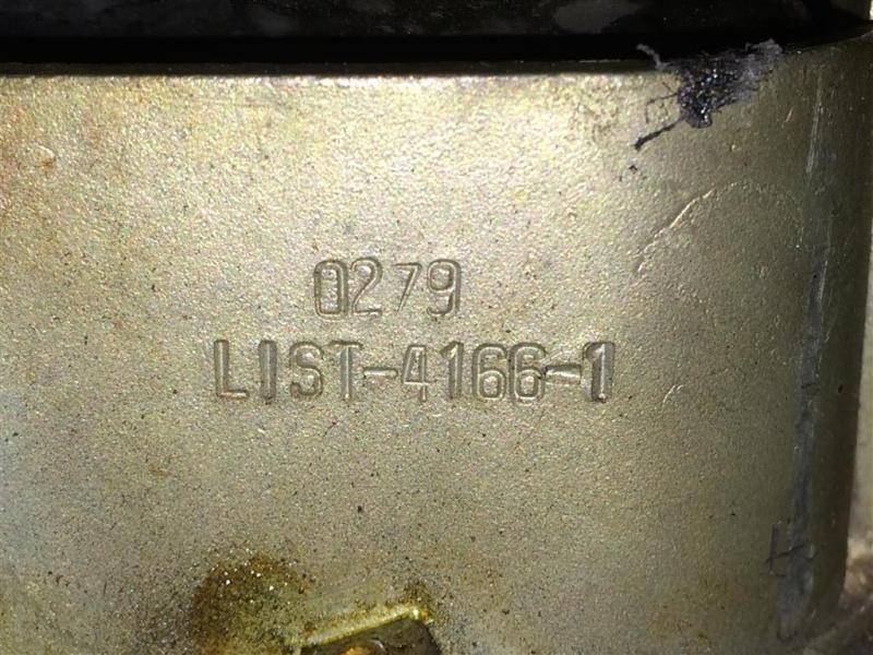

I suspect that it would like a cleaning, and now that it has to come apart, maybe a rebuild as well ? It only has 30K miles (if it's the original), but I am still indoubt if this is a good idea?
I was also wondering if this kit from Rock will be a good choice, and if it will fit. Rock don't write a whole lot about which carbs it will fit, but it looks universal to me. But then again, I don't rebuild a whole lot of carbs...

Well, you walk down to the parts store and tell them you want a rebuild kit for your application... they pull it off the shelf and you pull out the direction pages which usually list all the carb numbers the kit covers to verify its correct. Can't do that in Orlando anymore either, Denmark... I would be impressed.
I bet there is someone who likes Holley's more than I do here and they will supplement or correct me. I would strongly suggest you get a kit with the blue non-stick gaskets if possible. Holley, has lots of individual P/N identifiers that would require a teardown to find out exactly what you need. No offense to Holley, but our old factory carbs were often made very specific for the application and I have found very little info for the one I have (GM product factory carb) but many of the kits like the one you show have a variety of parts and gaskets to help them work a wide variety of applications. For a maintenance cleanup type rebuild, you should be fine. But you may find there is still stuff you want to replace but don't have. Different float types were used and won't be in the kit. A heavy float will run you very rich. You probably don't have an adjustable needle and seat on the fuel bowl, which means you will really like the non-stick gaskets if you want to take it apart again to clean or recheck adjustment.
I have never been a big Holley fan. They are a tuner's carb from another era... for the guy that knows how to set one up they built a lot of cheap aftermarket carbs and parts varieties to support that use. Those are the kits and part numbers I see online. Factory use carbs are numbered a little different and the Holley guys I know usually match up parts as they go from large tuner selections you and I would never use or want. Most if not all you need is available... but as far as I know a universal model kit like this will get you started and might not cover all you want.
Here are some links to Holley info including the more pertinent numbers for your carb... don't be surprised if you wind up needing a few separate pieces to match your factory build.

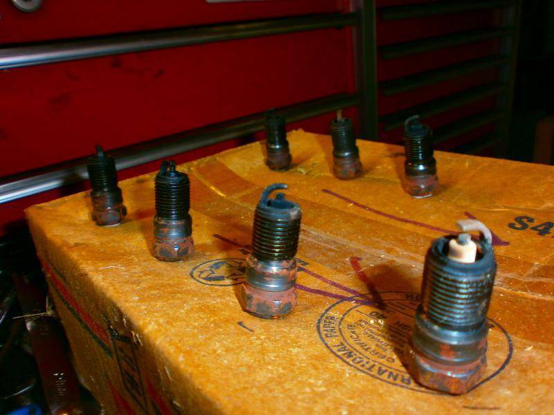

2- remove all spark plugs and keep in order... reading spark plugs has lots of online info... basics- good are tan/gray in color at the porcelain tip, black and powdery is rich, white is lean... not sure take clear pictures and you will get responses here.

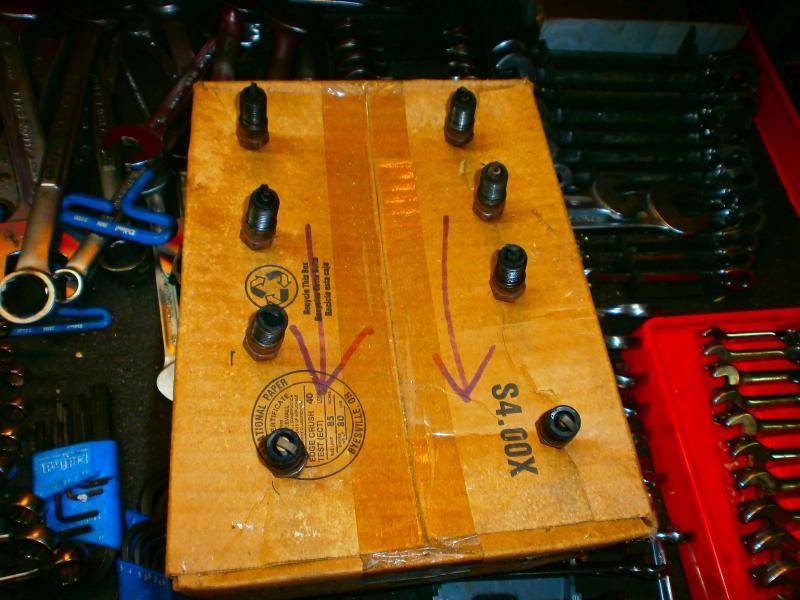

Keep them in order... if there is a problem you now know which cylinder
Left rich, minor deposits
Middle, burned clean, normal
Right rich
3 to left are rich, front burned clean, normal
These were not factory correct replacements... often cause issues. The fuel system was very rich the ones that burned clean are basically the only reason I could still start this engine.

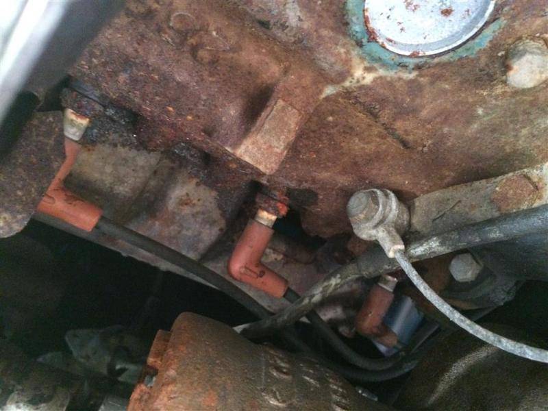

I did notice that my plugs were very rusty, from inspecting the car from below, and might even be "original".. so I also have 48 plugs in my "cart"..
So far, it's (ACDELCO R43S Professional Gap .035) for the Imp.. but will check my shop manual before making the purchase.

Your first answer (carb), actually made me think again about where to start. And now, I will go through the ignition system first for sure.. including the vacuum advance system (I hope this is what it's called). I didn't even change the fuel filter yet. I can only get measly little plastic ones here, and although being transparent, they would be practical in regard as to show what the gas tank has to offer besides gas, they are simply to small :). They too, are in the Rock Auto virtual cart. Both a transparent one for starters, and a the original looking metal ones, for when everything is sorted.

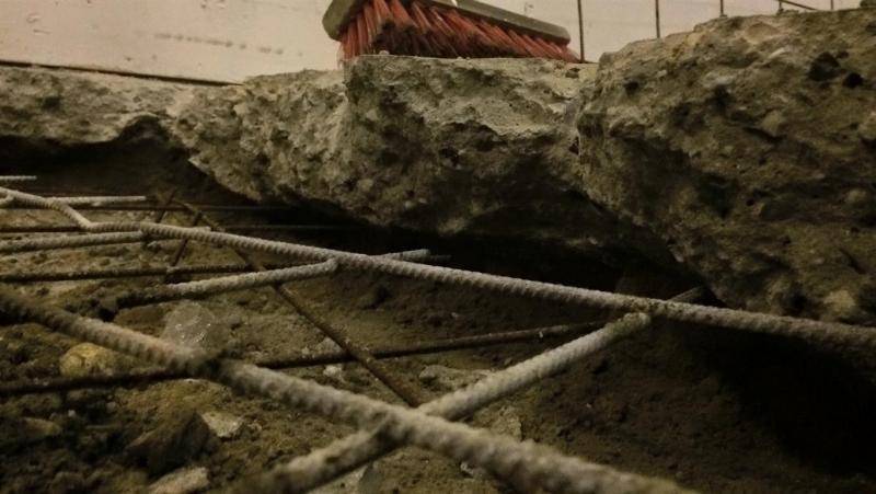

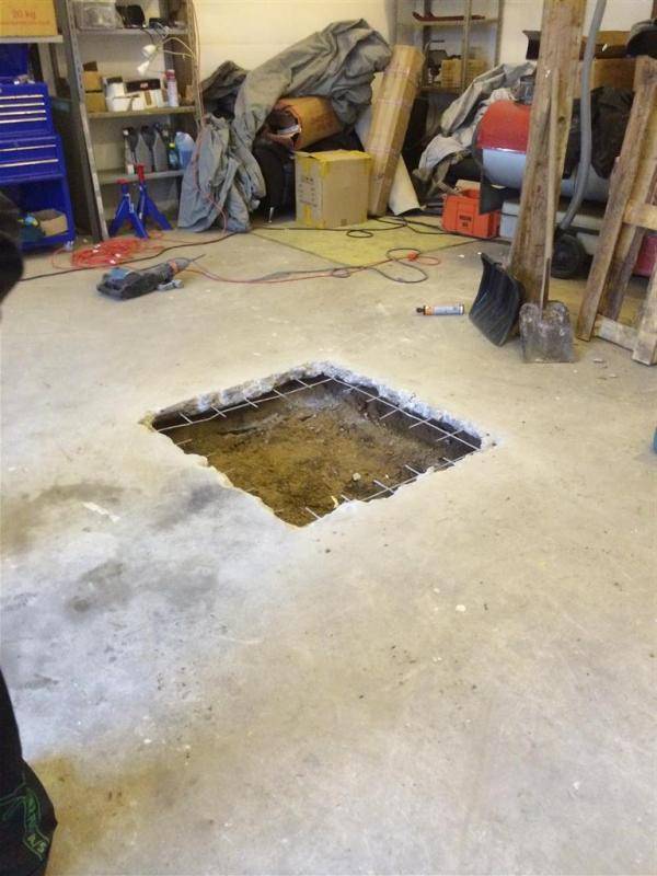

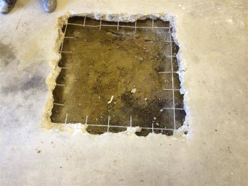

PS: My hydraulic lift is coming up soon.. had the garage floor re-cast today, for a more appropriate thickness. I wouldn't wanna have the Imperial nose dive into the floor. If that happened, I would never leave the house again! I hope it will be strong enough for the Imp...

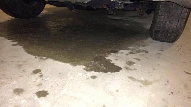

If the brakes are that bad, I would consider rebuilding or replacing all I could. Long after hard parts go obsolete, you may find rebuild kits. lines are easy and cheap to make... will need tools and practice to get a good "double flare" but don't substitute anything for the steel lines... use proper steel brake line... cheap and strong. if yours are obsolete parts search here and ask questions. Flush the fluid until clean... it will dirty up again with a little use... flush it after a month or so driving if it gets dirty again... eventually you will get all the crap out of the system. the more you rebuild or replace the less necessary it will be to get the fluid to stay clean. Then 2 year replacement interval for brake fluid is almost universal... and nobody does it.
I'm not a concrete guy, but worked around lifts my entire career. The standard as I understand it is 12 inches deep concrete base required for a 2 post... the 4 post need much less. Get info from your lift manufacturer as to their specs... not worth a few tons falling from 6 feet or more in the air. Your pics didn't look deep enough and may not be enough total area either.
