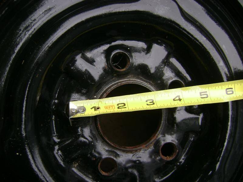

this?
how do i measure....from what to what...sorry for bein dumb
If you numbered the lug holes 1-5, measure the center of hole 1 to the center of hole 3.
Multiply your measurement by 1.05 and you will have the bolt circle. You should get almost 4 5/16" for a 4 1/2" bolt circle.

My 74 dart is/was actually 4 on 5. The disc brake cars however are 4 1/2 on 5. (Speaking about the A body)

1974 is a weird, bastard year for A-bodies. Drum-brake cars are 4", while disc-brake cars are 4-1/2". I've owned two '73 disc-brake A-bodies WITH 4-1/2" BP (both 340 Sports), but I've had A-body nuts call me a liar and all kinds of other BS...never mind I've owned over two dozen A-bodies, all back when people were not messing with suspension swaps on these.
I'm still convinced that the 1973MY was the first year for the 4-1/2" BP on the A-body disc brake cars.
