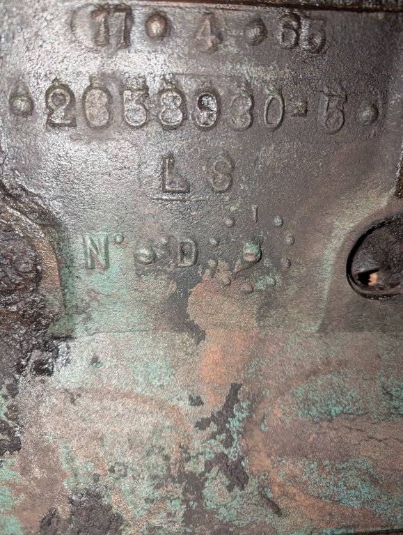

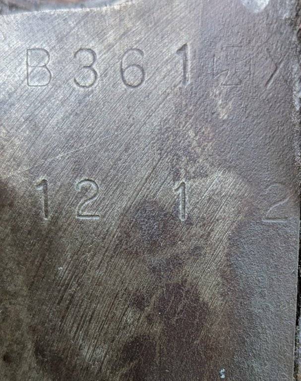

I did forget to mention a few things, the long block 361 I'm currently rebuilding right now indeed is a 65/66 casting, so the cam that's in there is probably the 256/260 .425 cam, the 361 in the vehicle right now is a 64' casting so that engine probably does have the 252/252 .390 cam.
Another i forgot to mention was, the rear gear in the vehicle right now is indeed a 2.76.
The machine stamping confirms that it's a 66 block and the machine work
(at least to the crank) Is listed.
I have measured the crank connecting rod journals again and it looks to be 2.3750?
Still confirming if that's the correct reading on the micrometer.
To be honest I don't mash the pedal to even notice if the converter in the transmission now gets the vehicle to jump off the line quicker, just worried I'll break something else, especially in a freshly rebuilt A727.
Edit: adding in the machine stamping from the other thread.
Upon further review, correction, the block is a 65' casting but I'm hoping the 66' cams kind of "bled" into the early 65/66 blocks.
Casting #2658930
Just looked through the new car sales brochures at www.eatondetroitspring.com AND in 1966 model year, the ONLY place the 361 2-bbl was used was in the 1966 Dodge Coronet/Charger cars. 318 2bbl was standard, 361 2-bbl was the first optional V-8 (which could be paired with a 4-spd manual transmission or TF, no 3-spd manuals for 361s or 383 4bbls), with the "next-up" optional engine being the normal 383 4bbl that year. NO Plymouth B-bodies, just Dodges. No C-bodies, either, as they used the 383 instead.
As the 383 2bbl had the 252/252/.390 cam, I suspect that is what was in the 361 2bbl too, in 1966.
