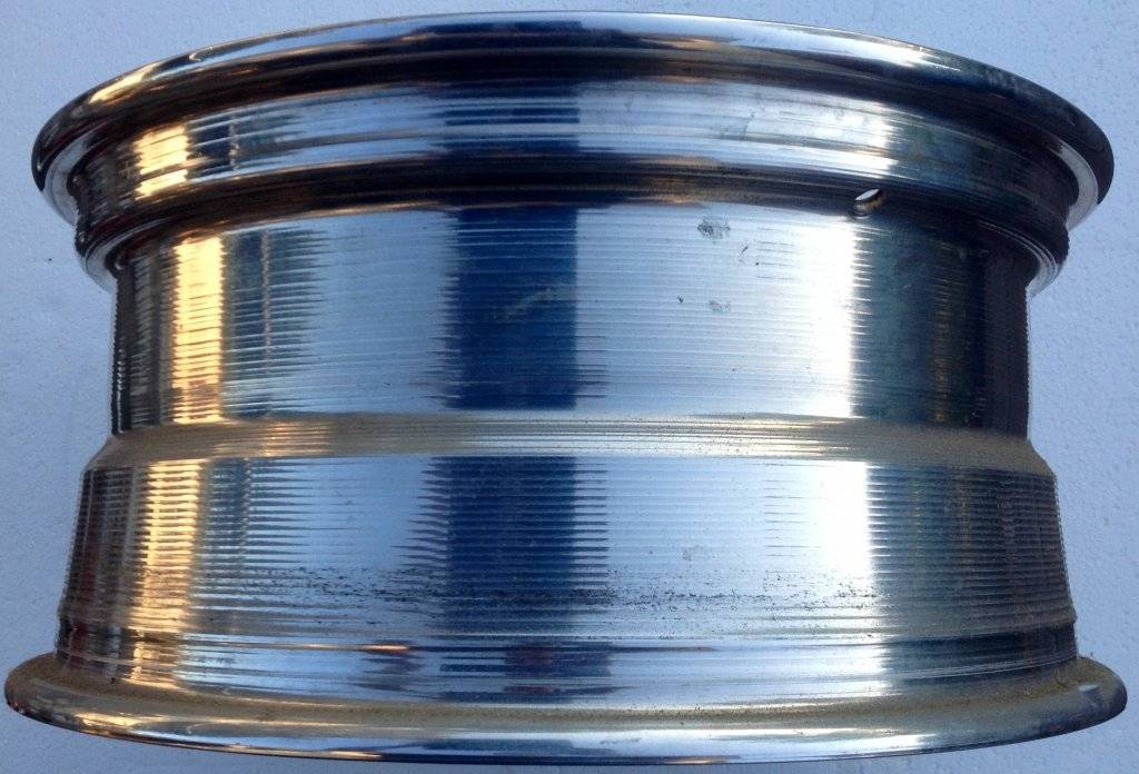

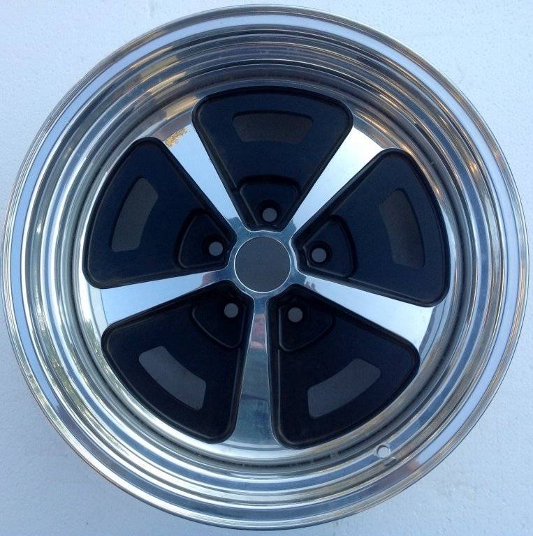

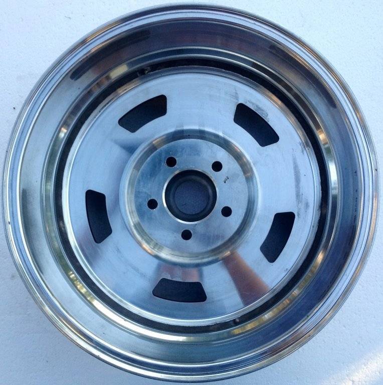

Would like to order a set of aluminum magnum 500 wheels. They come in 8X17 front 9X17 rear. Not sure about back spacing.They come in 5" and 51/2" I would like to order the 5" back space. I like the deeper dish look. Will they fit?
The rears should fit. Take measurements on both sides. Ma wasn't known for always perfectly centering her rearend assemblies. Even if it's close, you can always use the offset spring hangers/shackle kit to move the springs in .8". I would take several measurements up front. Both will also depend on the tires you run. Btw: If you're interested in (1) of the 18" billet Magnum 500s, I have a brand new one that we had on display (see pics below). I believe it has an 8" or 9" width (would need to check the backspacing). I can let it go pretty inexpensive. Also, you may want to check out your tire choices between 17s & 18s.
