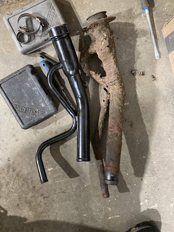

Filled up and diesel ran out of the vent / puke tube.
Lo and behold, the puke tube was rusted.
Ordered a replacement from Amazon and it was the wrong size (too short), so that will be returned.
Pulled a filler tube from another truck and installed it.
