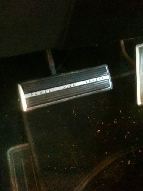

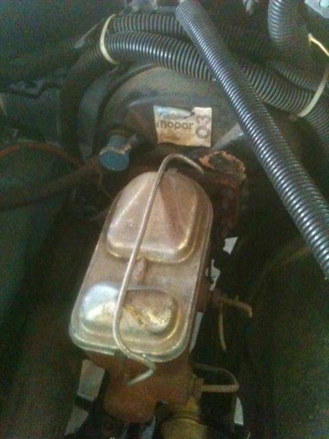

I have a 69 300 and when you really mash on the brakes it pulls slightly to the drivers side. I am about to start going through the brakes, but i noticed the previous owner has made a few modifications. The brake pedal says power disc brakes when the car is clearly all 4 power drums.

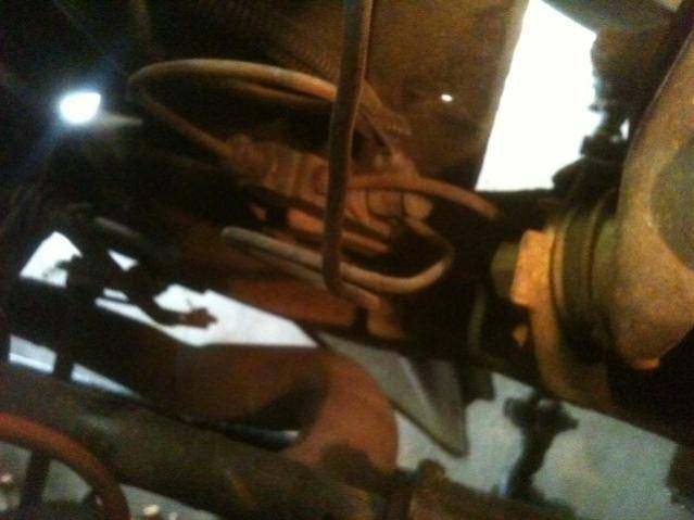

I have attached a picture of the master cylinder and proportioning valve. Are theses the correct units for a power drum car or do i have a master cylinder for a disc brake car?
I plan to eventually switch to front disc brakes, but finances do not allow currently. I'm just trying to get the big girl to stop straight.

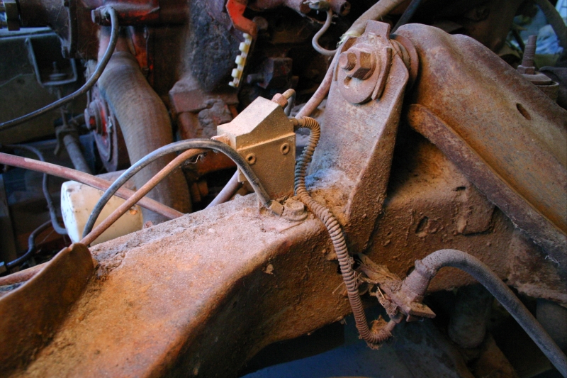

That is a disc brake master, disc brake cars typically had a metering block just in front of the control arm.
(ignore the ground wire, that was a CHP thing)
