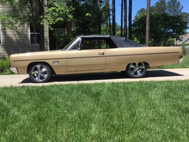

I just ordered a new set of wheels and tires from a company in California that ensure they will fit. Once they get here I guess we'll see. I'd love a parts list from you on the disc brake conversion if you have one.
Foose wheels =
18x8 front with 225/5018 tires

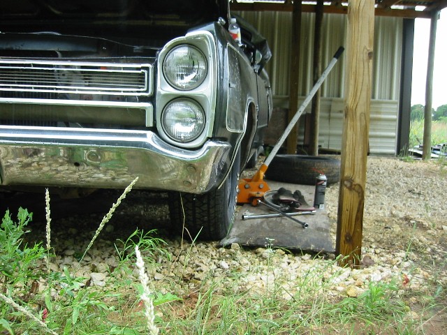

Height-wise, I put 275/60-15's front and rear, but on relatively narrow 15x7 cop wheels:
275-60-15_Front-01 by clair_davis, on Flickr
275-60-15_Front-02 by clair_davis, on Flickr

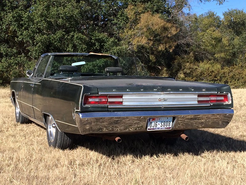

Was probably tightest in back, but I didn't get a pic of that since the tires don't move around much. An 8" wide wheel would square up the tire sidewall more, but eat up more space. I ended up going with 235/65-16's on 8" wide wheels (0" offset or 4.5" backspace) that fit great, and are the same height as the original 235/70-15's:
68_Sport_Fury_V-45-01 by clair_davis, on Flickr
68_Sport_Fury_V-45-05 by clair_davis, on Flickr

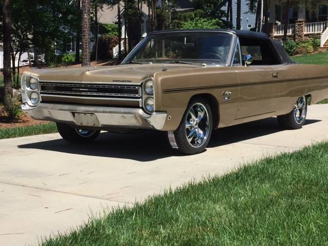

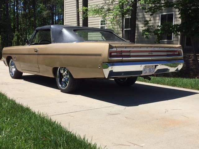

Installed my new shoes today.
