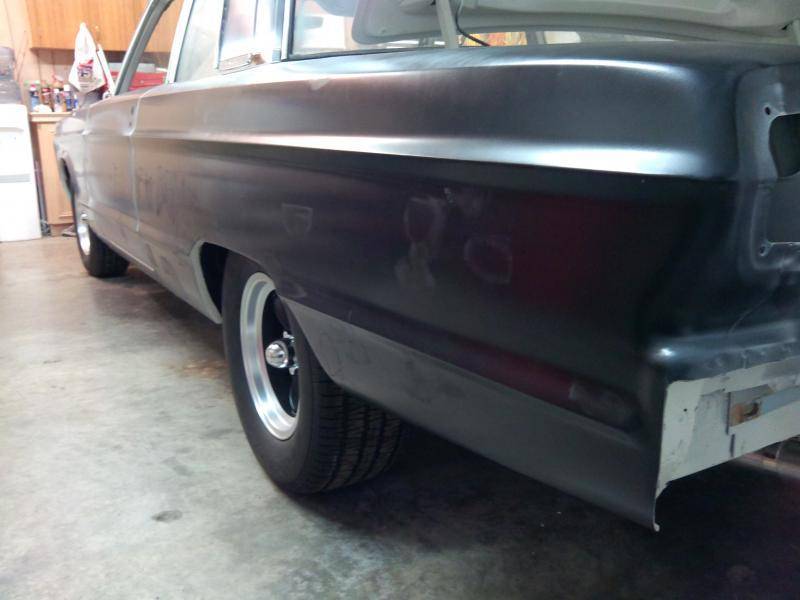

I have a pair of P275-60R15 tires on a 15x8 aluminum rim on my 65 Sport Fury. Not certain what the offset is, they fit (it's tight) but without the skirts. I had the same size tire on a 15x7 cop rim under the car and the skirts would still go on.
Hope this helps.

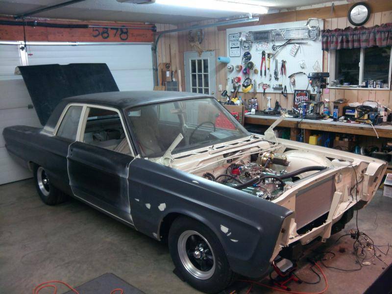

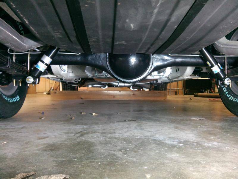

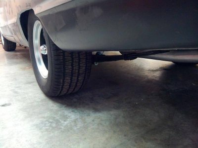

Here's whats on my 66 Fury.
Rear: 275/60, wheels are 15x8 with 4.25" backspace
Front: 225/70, wheels are 15x7 with 3.5" backspace
There's about an inch clearance from tire to fender however I still have to jack up the body and let the rear end down a bit to get the back wheels off.
