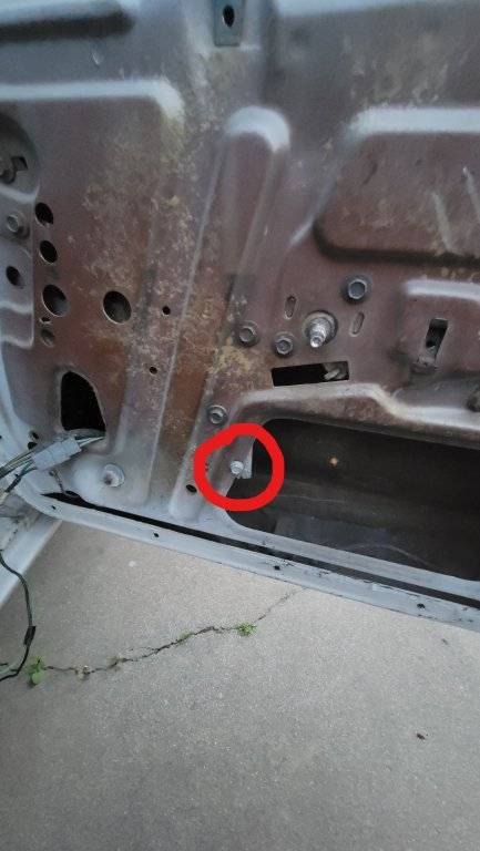

4 door HT. The window is up. Looks like there is a small hex screw through the door panel and lower regulator arm keeping the window up, seen on the attached picture.

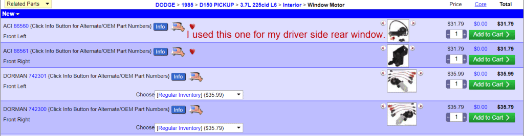

For my 70 fury you can still get the originals but they are expensive and you have to send your core back to get a refund. I used the window motor from a 1985 Dodge truck for one of my rear regulators. It is plastic but it bolts in and is much faster speed than the original motors.
