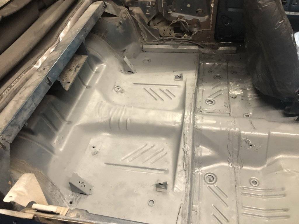

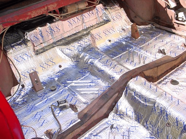

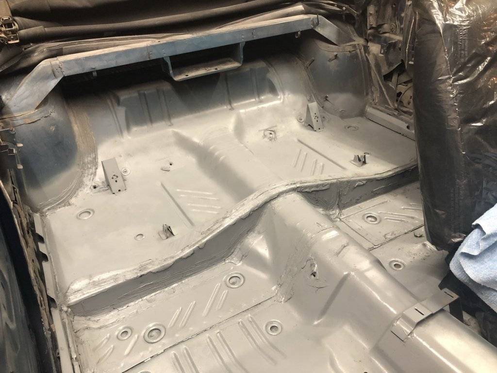

I'm not sure if this helps or not but here's a couple of pics of rear floors. The first one is mine and the second is from @bluefury361 's 69 300 vert.
There are 4 mounting brackets welded to the floor plus the brackets for the seat back. The outer 2 aren't quite as visible (I wasn't taking pics of them) in mine, and only marginally better in Will's car.
I don't know if the convertible seat mounts are different. The seats are.
My car isn't home right now... Stored up in my son's garage until they are done putting the new roof on my house. If need be I can easily pull the rear seat and snap some pics when they are done and my cars are back home.
I'm wondering if @MrMoparCHP might have some rear seat pics he could share.

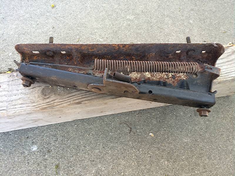

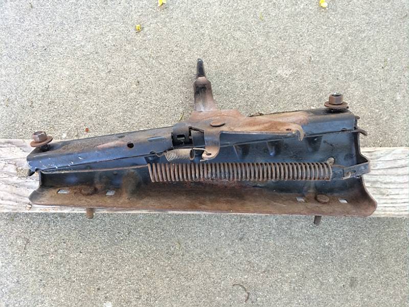

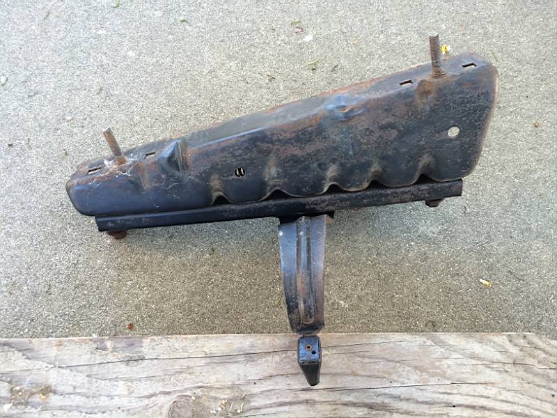

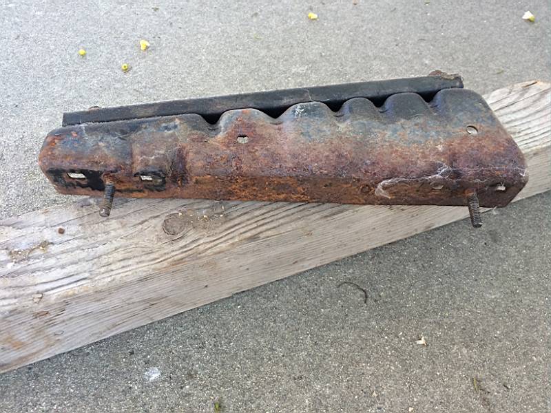

And no, I'm talking about the FRONT bench brackets, not the rear. The rear brackets are in good shape.
B body seat brackets will not work in a C.
The time spent making the repop panels fit is the same amount if you fabricated your own from scratch.
Those panels look better patching up walls of an old barn.
I have some from a right bucket seat, but not sure they are the same.
The floor itself just had holes, the reinforcement was under the pan, they are there even on bucket seat cars.
Here are some pictures of the brackets. I had a some spares from a parts car but were cleared out long ago.
Alan
