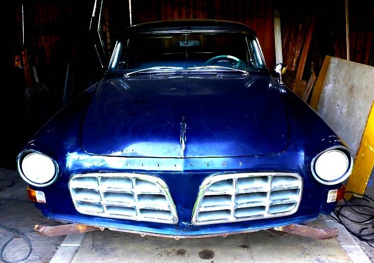

When I got my -56 New Yorker it had a Windsor grille (I find it better looking so no sour face from me about that) & it's been in some crash maaany years ago, probably spinning around hitting different objects on different spots of the body before coming to a stop...
The damages hasn't been to bad, just small dents in different places exept passanger side rear fender; someone's been putting loads of bondo after trying to get the dent out but waited to long so under the platic it was rusty all over...

Anyway, as I have a limited space lengthwize I bumped my legs on the silly bumper corners & was rather happy when I got offerd Imperial grilles + bumper for cheap! Ony to find the bumpre really rusty & the grilles cracked from accident...
But I thought "what'he fudge, (!) I'll use the stuff anyway cus it'll look better on distance & I prefere it!".
& so it's getting there slowly, the edge going from the tops of the grilles shows it used to be a "normal" -56 Chrysler:
I think I'll remove the hood ornament too. At the moment I've cut & welded the corners where the old indicators used to be & am now working on the bumper; cleaned it up by welding the old holes & put some alu primer on, a habbit from my shipping years... I've also changed the possition for the bumperettes:

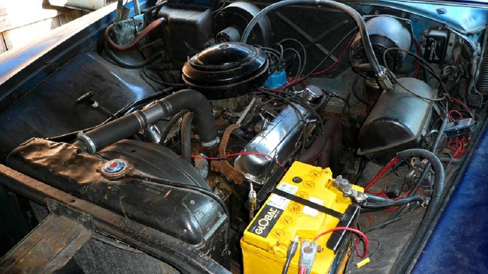

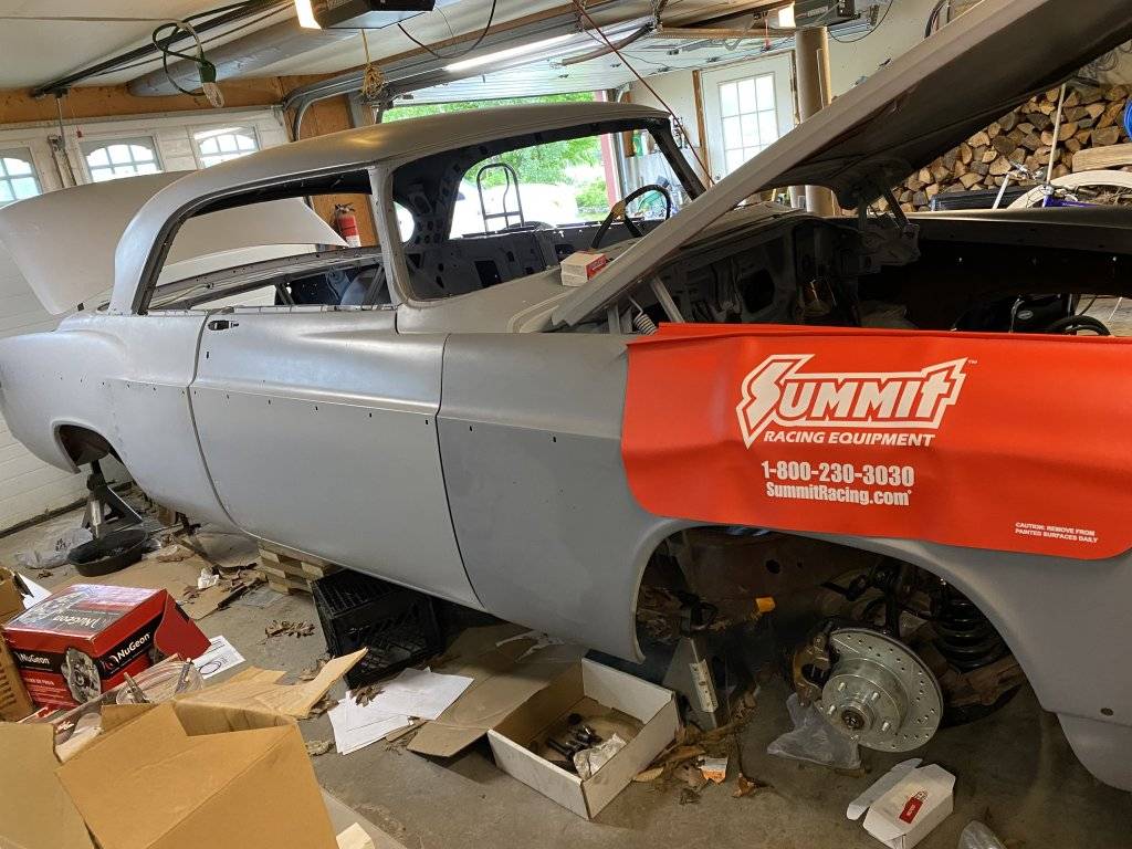

Nice! I'm part way through my 1955 - 300 clone project, from a Windsor.
I'm also converting to 12V and a 4 speed.
Got the stock motor or something else? Is the new yorker a 354?
I sure wish the Hemi still lived there but it's long gone, now it's a 318 & A500.

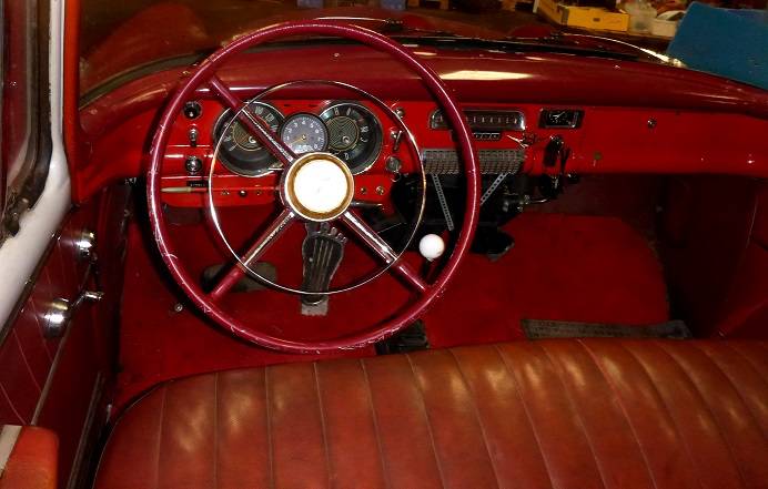

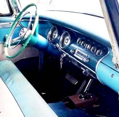

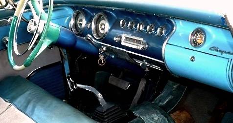

& some owner before my time had put a B&M shifter kit under(!) the dashboard for making it possible for 3 persons at the front seat, & to do that they had cut the shifter half way so it was really hard to shift...
I've spent weeks in the begining to make it work by moving it & putting it in different positions + drilling the shaft pieces & bolting them together a bit "side-by-side".
Now it works but I wanna put a Hurst shifter in instead. I have a Hust in my Studebaker, maby I take that one & sell the Stude with something else.

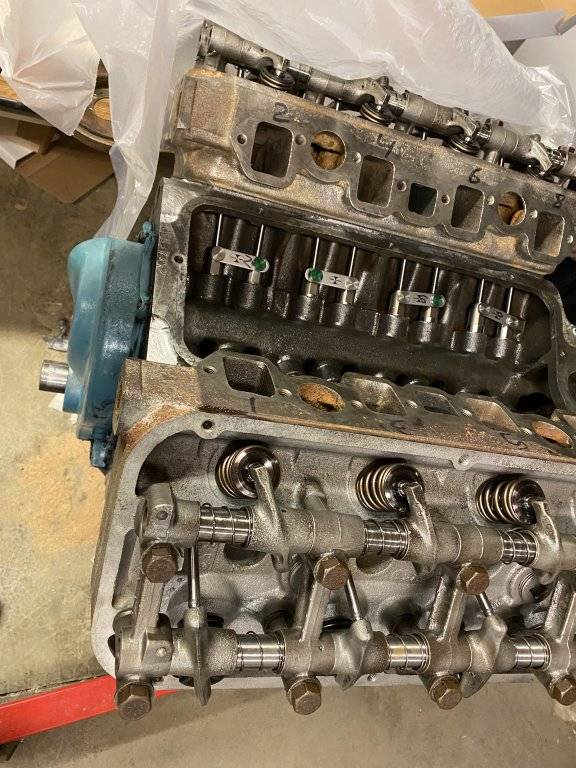

So what's the size of the Hemi?

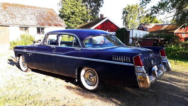

Mine is a -56, I woulda prefered -55 but this one came for a price I could afford. & it's a 4-door, I'm a family man so that's what I usually go for these days.
Here's a pic from when we piced it up & it stopped halfway & had to be towed due to rust in the tank & the result of that...

The iron hemi is a 331 out of a 55 Imp.

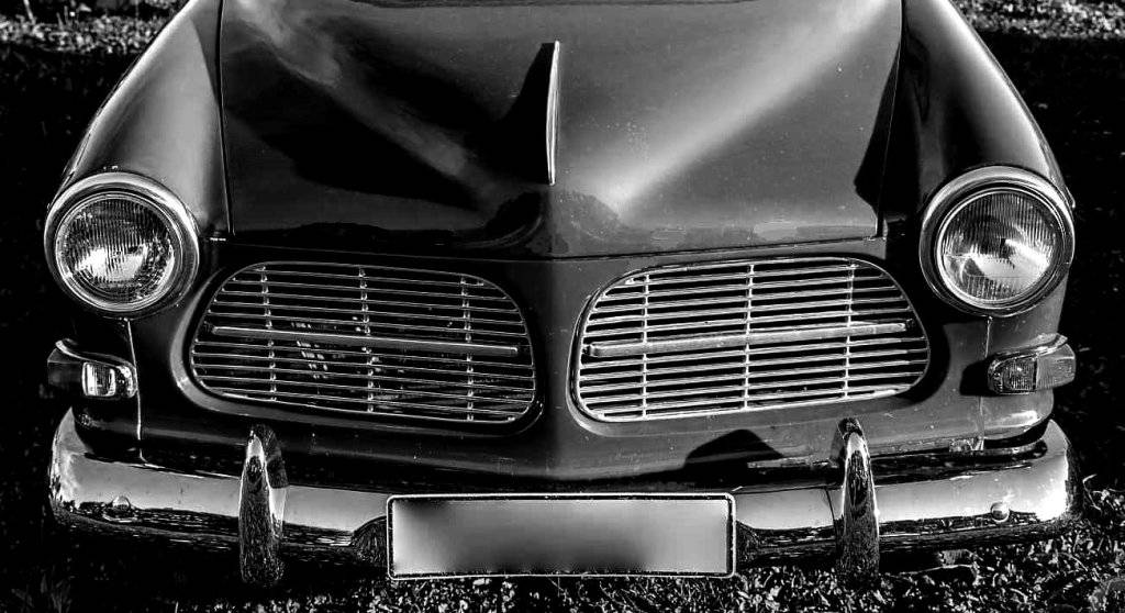

Done the front now exept the bumper surface. I'm gonna fool plenty swedes when meeting them on open roads; I've on purpose put the bumperetes in a certain position & picked indicators to fit & a small trim bit on the hood... Thou I haven't done the surface around the the hood trim yet, the face I'm copying a bit is the Volvo Amazon:
(122 to people outside Sweden)

I know it won't fool many in the long run, just a few people a few seconds is enough...
