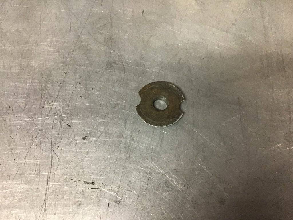

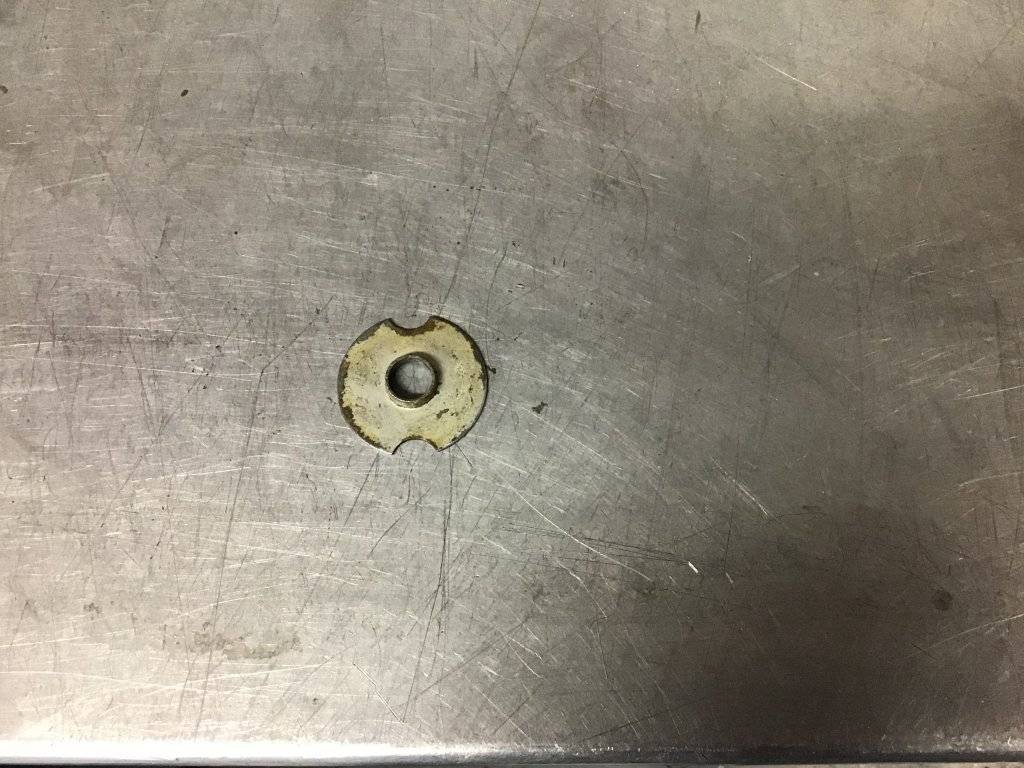

Finally after putting it in and taking it out 3 times I got my driver side window working . I tried using some furniture pad felt in the glass run track but it was too thick and bound up on me , so I found out using 3/4” wide Velcro on the bottom and sides works great , 1” would be better for the sides but I don’t think it matters ? I used that 3M #77 spray adhesive. Only problem is a washer fell out of something and I can’t for the life of me figure out where it came from ? I will post a photo of it if anyone knows where it goes. Otherwise it’s been a great day.
