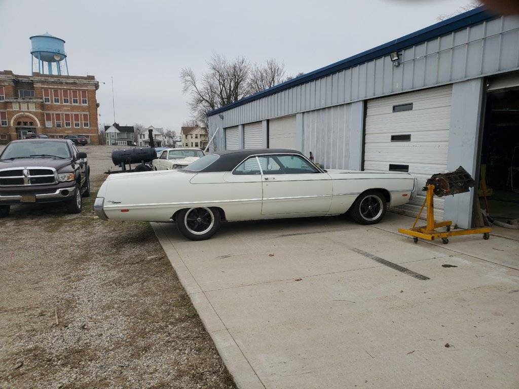

Just brought her back from Indiana. 70k miles. My brother put on the wheels and tires from his 78 Road runner.
Trying out some pinstripes.
She needs a little work but is going to be a lot of fun.

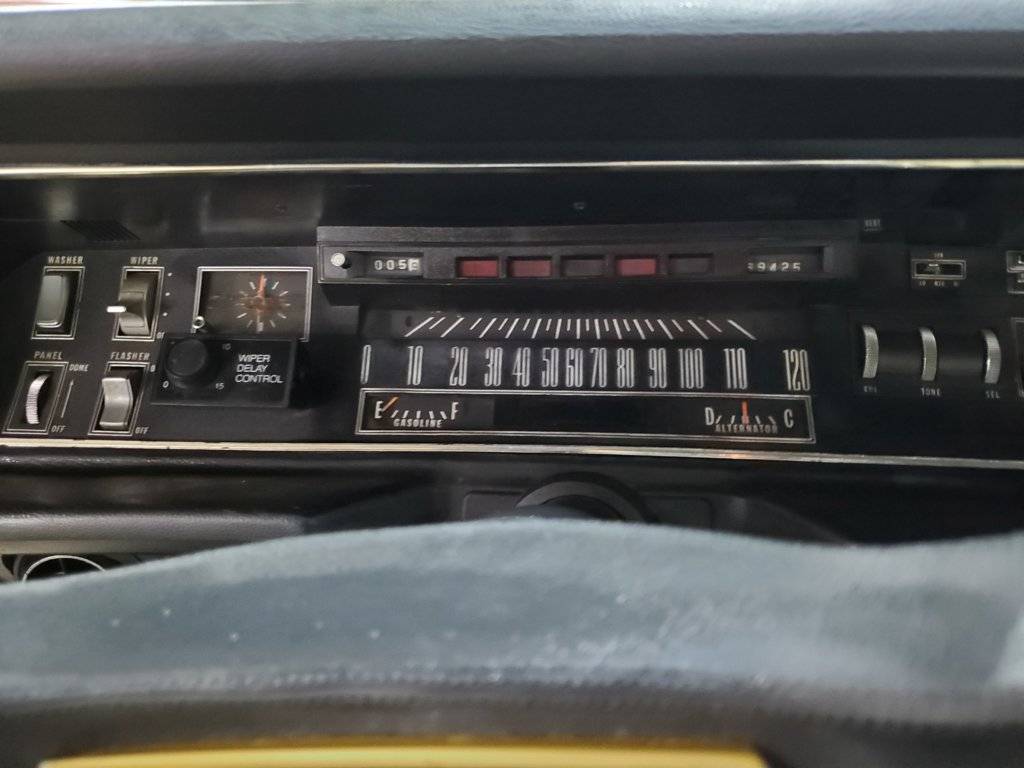

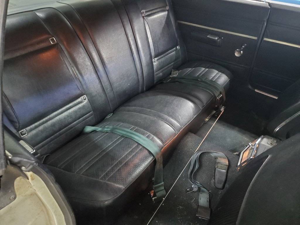

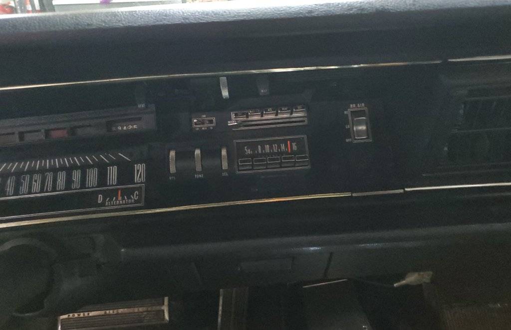

Cleaned up the interior.

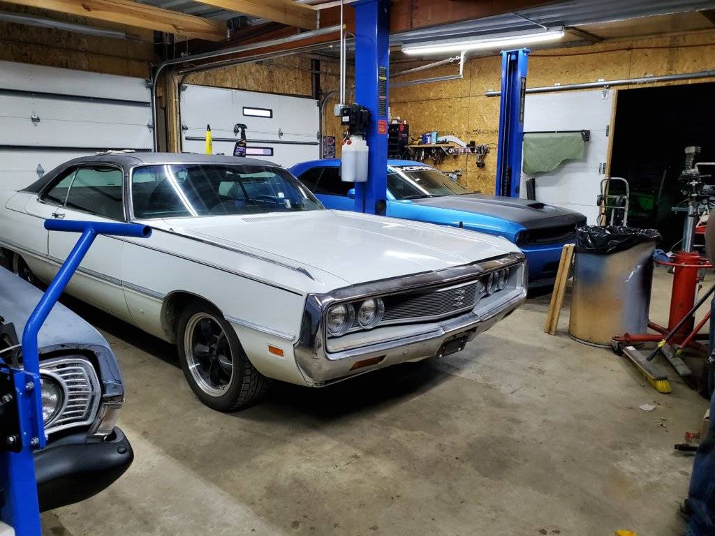

One more pic of her inside the shop. Tomorrow is supposed to be pretty so I will try to get some more pictures then.

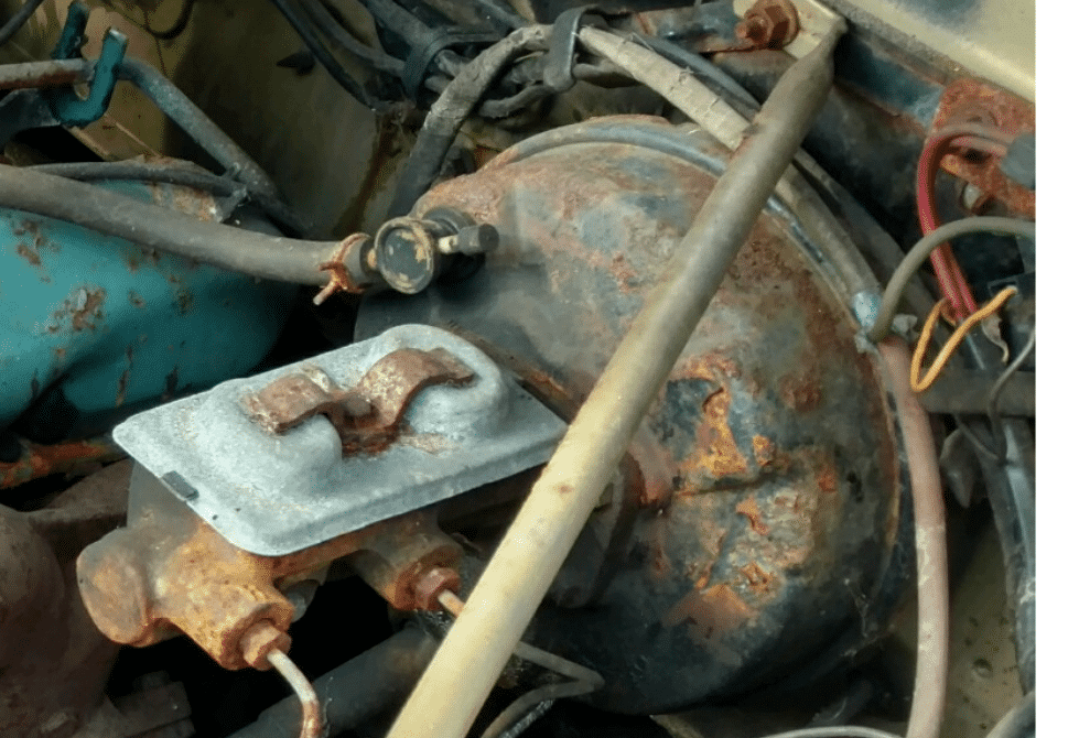

My experience is that the power disc master cylinder had the spring cap retainer like yours and mine but the power drum cylinder had one bolt in the middle like this one.

Update, Just to be clear, I was not picking at your car, anomalies interest me so when you mentioned your pedals I was very interested, When I looked at this car when it was for sale, I assumed it was power discs. I love your car. I think the booster and master cylinder on your car are for drums. That's a drum brake booster and a replacement drum brake master cylinder. Power master cylinders have a larger rear reservoir that feeds the front discs, your master cylinder has the same size reservoirs front and back.
