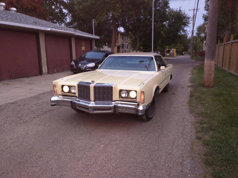

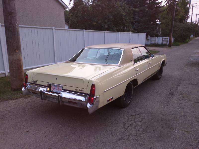

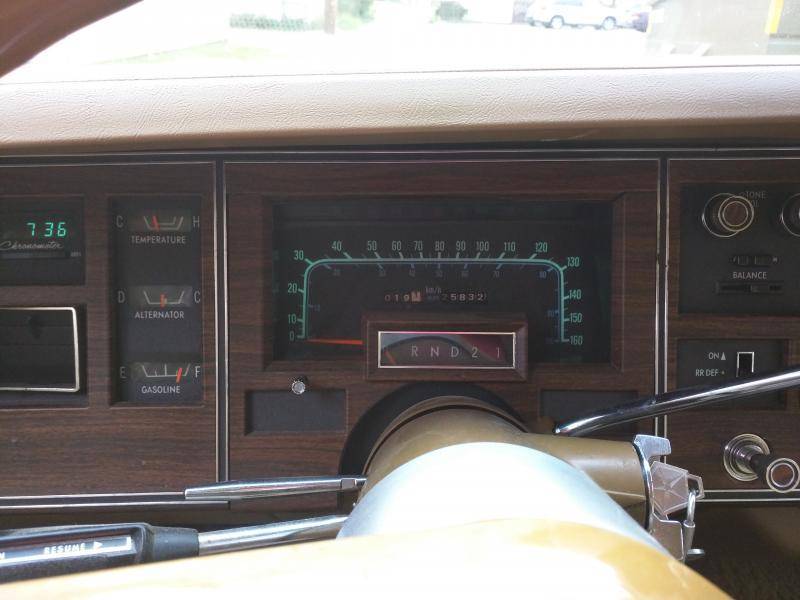

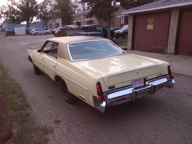

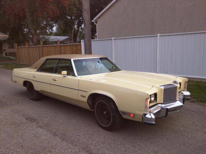

Sorry for the long post. I'll pay you back with pictures:
IMG_20150826_193539.jpgIMG_20150826_193552.jpgIMG_20150826_193602.jpgIMG_20150826_193611.jpgIMG_20150826_193642.jpg

Very nice car.
Where are the wheel covers and skirts?

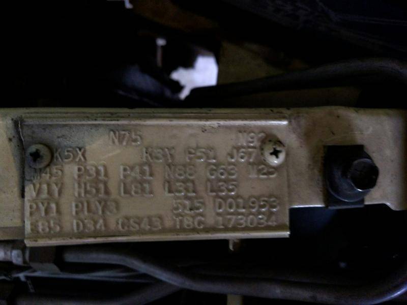

I would like to see a close up picture of your fender tag on the radiator core support. I can decode it for you. Also a picture of the production tag on the driver door. We are looking for the last C-Body ever built. My NYB was Feb 78 and my Newport was May 78. There are a few guys here that have been built in July 78. I found the build sheet in the driver seat back of NYB and haven't looked for it in my Newport yet.
Here is a pic of the door sticker, the fender tag and also of the original shipping order. The car was ordered by the dealer and driven by the dealer's wife for a month or two, and then sold to the guy I bought it from. He stored it when he bought a smaller car for his wife and daughter to drive.
Wheel covers and skirts are in the garage waiting for the new tires to go on today, then they will be back on.

THAT is a sweet C! Please post some photos when you get the wheel covers and skirts on!

It's great to see I time capsule like this beauty.
Welcome aboard. What he said about posting more pics with the covers and skirts in place. Nice ride. You will get lots of support on this board.
