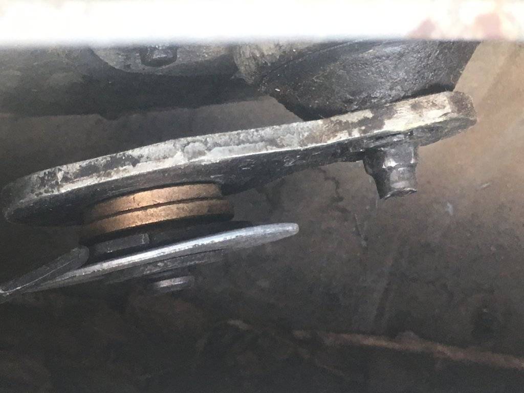

So I mentioned in passing about replacing my broken large plastic wiper cam with some bronze bushings from the hardware store. Don’t recall exactly what I did as I was in a hurry to get it done due to procrastination and an impending rainstorm. What I remember is buying a bronze bushing that fit almost perfectly in the arm, another bronze bushing that fit on the wiper motor shaft and then inside the aforementioned bushing, spacing it out with washers, a large fender with an Eclip to hold it on. Seems I had to either cut or fold the relief on the wiper arm to clear something. Sorry it’s not clear I just didn’t think anybody would ask about it

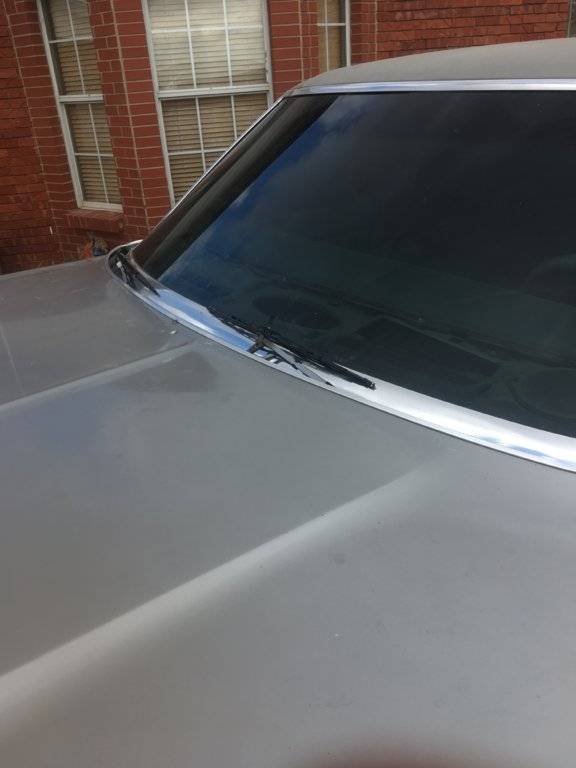

Also I lost my hidden wiper feature but that’s the cost of putting off today what I could do before I have to drive in a rainstorm lol ... and it cost less than $10 iirc
