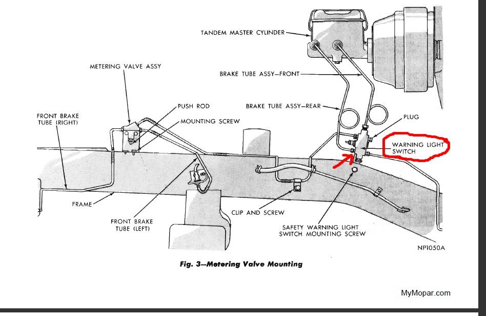

Could be some blockage in the rear brake part of your warning light switch.
