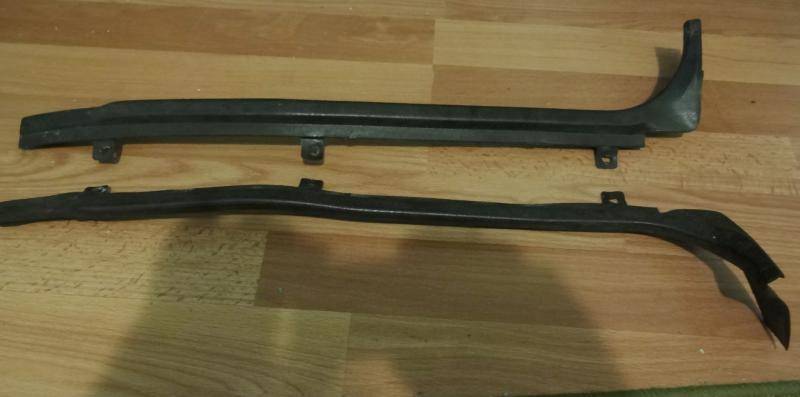

I finally got around to installing the rear interior quarter panels on my 70 2 door. I'm missing the trim that covers the edgeoff the panels and metal door opening lip. The trim continues down the door opening lip and covers the rear corners of the carpet, and the sill plate covers up its edge
The parts book calls it a "weathercord", or "cover".
Fits all P-D-C 2 door H/T & convertible. (This from the 69 parts book). Should be the same in 70.
I have this pair from a 69 convertible if it helps.
I always called that a weathercord too. The 69 parts book calls it both, depending on what picture you look at. A "pinchweld" molding/cover, as Alan called it, sounds the most descriptive.
I thought wind lace is flexible. The trim I need is what you pictured, the hard plastic cover. Will it fit a hard top?

I believe he showed the right part. My back seat doesn't cover the rear corners of the carpet so the piece needs to get bigger at the bottom to cover it

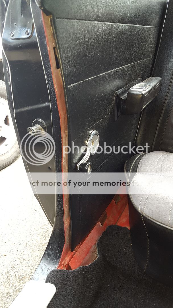

Here is a picture of my rear inner quarter. I must be missing 2 pieces because that trim piece you guys pictured would only cover the pinch weld, and it looks like Im missing whatever covers the body/carpet below the panel
No, that is all there is to the trim, HT and vert. The carpets in mine go right up the the edge of the panel, looks like they are a little short in you picture.
The carpet should roll right up the side and tuck under the panel.
Now...
I AM assuming the seat in the picture has been moved to show the area you are talking about.
Otherwise, we have a bigger problem here.
No you assume wrong, that seat is fully installed.
The lower seat matches the backrest, which has the notch for the polara nameplate, so I never suspected it was the wrong seat.
Do I have the wrong seat? ?

I think the carpet has been cut incorrectly, leaving it too short to tuck under the door panel and the seat.
I can't say for sure but I thought only the 4-door rear seats had the front corners curved.
