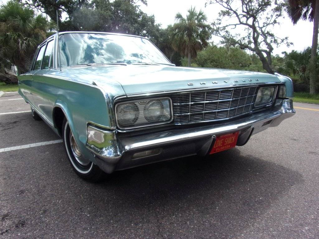

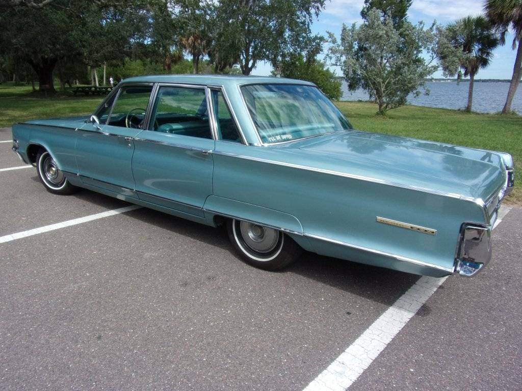

Hello all,
I need a windshield for my '65 New Yorker 6-window Town Sedan. Does anyone know of a source for a new (or used) windshield for this car? The part number seems to be
DW658T, T is for "tint". Classic industries offers 657T, but that it evidently for the hardtop, and not the sedan.
Any constructive, informative, insightful, and kind input from you fellas (and fell-ettes) is welcome. Stubbs need not apply. Thanks.

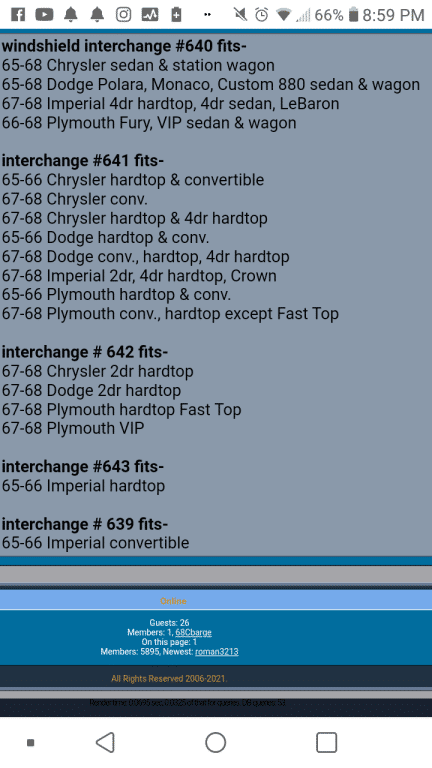

To save some leg work, here is the 8nterchsnge parts list.
You can give the glass shop the number and they can cross reference it.
Courtesy of the other C body forum...

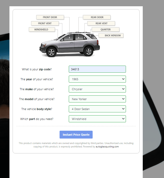

Has anyone used Autoglass.net?
Is it too good to be true?
The site shows I can pick up an Imperial windshield in Buffalo. But seems to want payment before confirmation.
