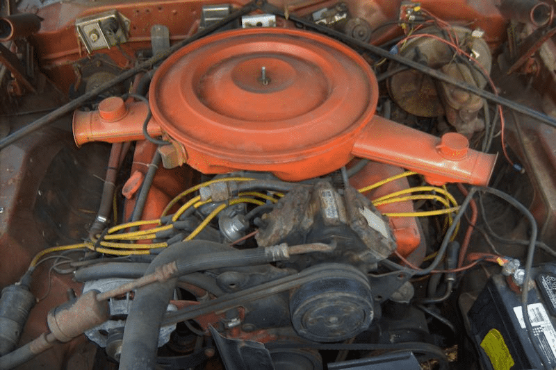

Not sure if these will be any help but this is a 72 440 I did. I do believe they changed the brackets up slightly after 73.
Going through my engine bay collection most of what I find is pretty cluttered engine bay shots which may not be much help.

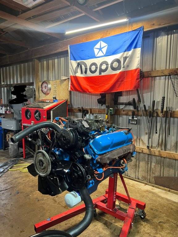

here's a 1974 440.

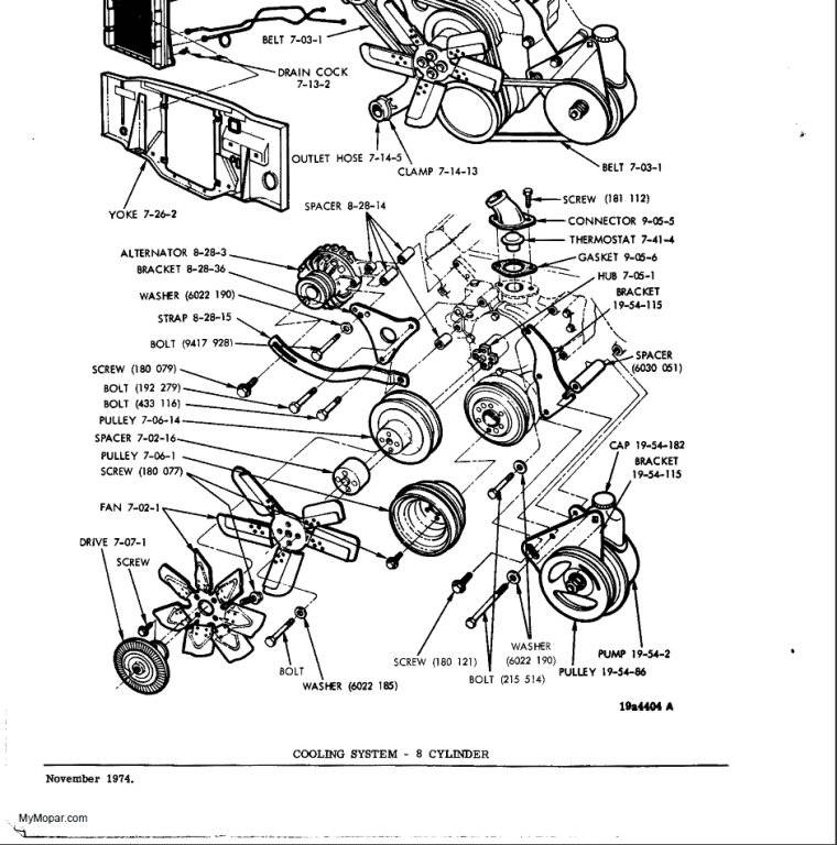

The parts manual may be of some help, this is from the 1974 parts catalog but it seems that the air conditioning chapter (24) is missing from all the manuals I have.

here's a 1974 440.
Chrysler; thanks for the reply but its hard to discern the mountings from these pictures. On the upside I found a picture I posted when removing my air conditioner and that has a close up of the power steering bracket. All I need now is a close up of the alternator bracket. Your pictures did however help with the hose routing. Thanks Paul
