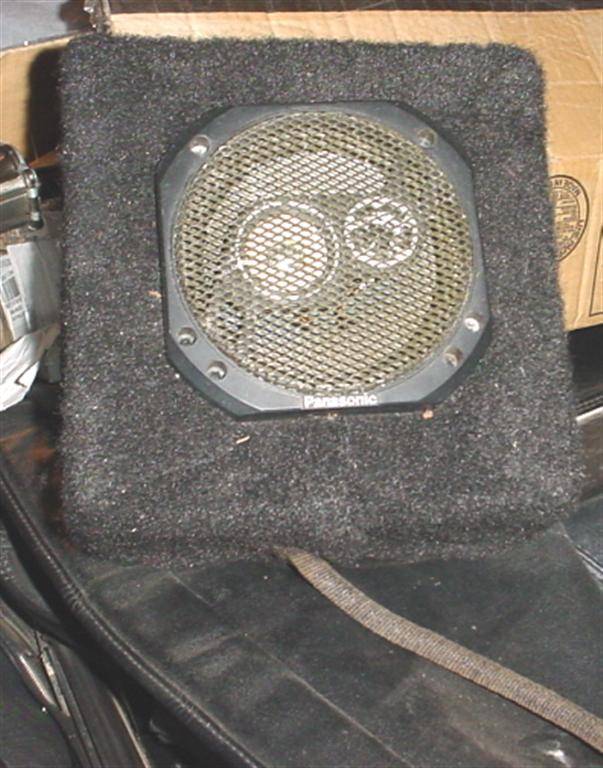

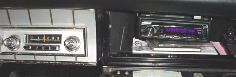

Thats what I did in my 65 convertible. I didn't want to cut into any of the original trim panels so I made plywood boxes to mount 5" round three way speakers... Lined them with styrofoam inside and carpet on the outside. I then used 12 feet of speaker wire and RCA jacks so that I could move the speakers anywhere in or out of the car, or remove them. (I hid a Kenwood radio in the glove box with am/fm..CD..MP3..) It sounds great.
