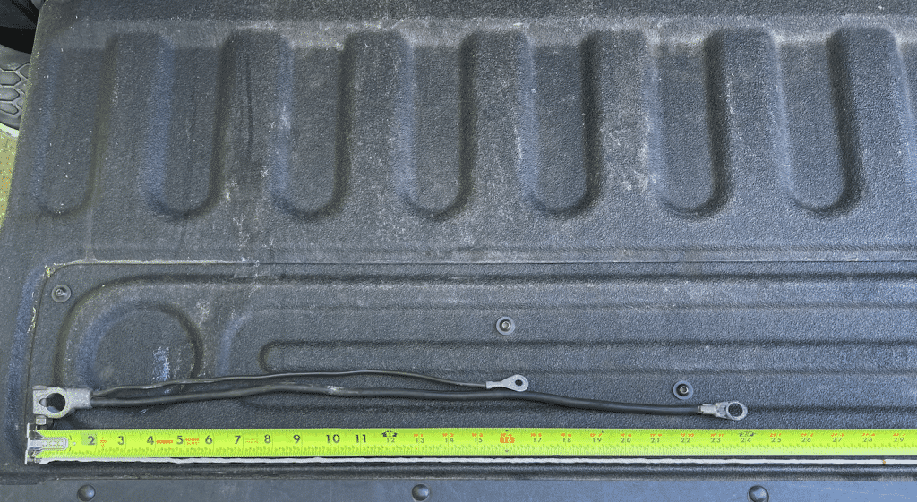

Does anyone know of a source that sells negative battery cables, with the body ground having a terminal (not a butt connector like the auto parts stores ones have) in ready made lengths? (See photo) I bought this 24-inch one 20+ years ago. Now I could use a 30-inch one. This is for my 72 Imperial. Thanks for any info and/or leads!
I guess if this is a one time need, this might not be for you. I have a farm and about 7 classic cars in the works so I make my own cables. You can get the terminals with a solder pot you drop in, heat and it seals terrifically, then heat shrink to seal it up again. Cheaper than trying to find "ready made" cables as in material cost and time trying to find. In Canada, I go with the PICO or Quick Cable. There will be a similar suppliers in your area I presume.
