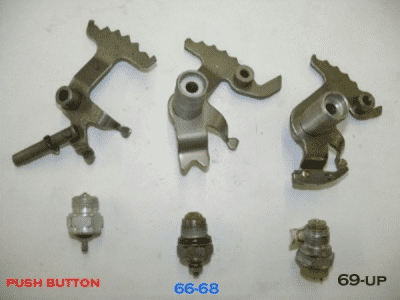

Neutral safety switch
What trans 904, 727, 3 speed, 4 speed etc
727 with single pole switch?? Dont know where to get one for cheap, but I think there are some around still..... A&A, Classic, Ebay
Quite a few on eBay these days. I just got one. Just look around for the best deal.
If it's the one with 2 connector prongs, there are many options.

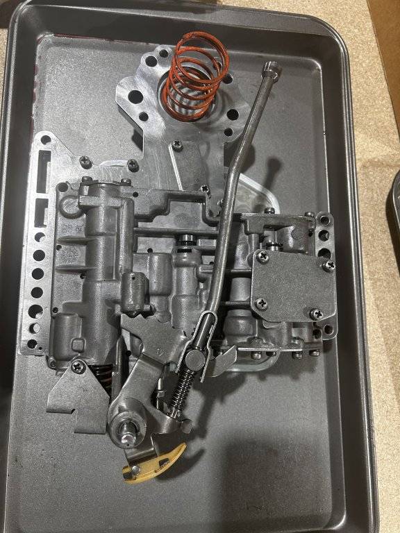

Crazy how the rooster combs get change to another one in a rebuild.
I also wonder if they started installing newer model year components as they ran out of parts in the existing model year. Maybe Elwood’s transmission had the 69 and up rooster comb and switch?
I do know that the neutral safety and backup light functions both work on Elwood as he sits.
