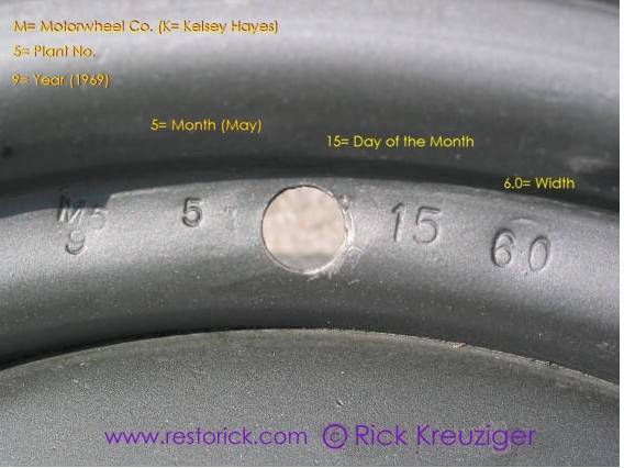

GM big cars had a 5x5 bolt pattern too. could the MW be for Motor Wheel?

Here is some reference i managed to dig up, its late, I'
m not working right in the head though. May research more tomorrow.
The more I look at these wheels, I believe he did measure the lug holes wrong. Again, these are defiantly Chrysler wheels, G.M and Ford never had the wheel centers like Chrysler. For the price I say get them, to cheap to pass up.
They look like the wheels in Wolfens pic, but maybe they got chromed and he just painted the centers and outer rim for a different look.
