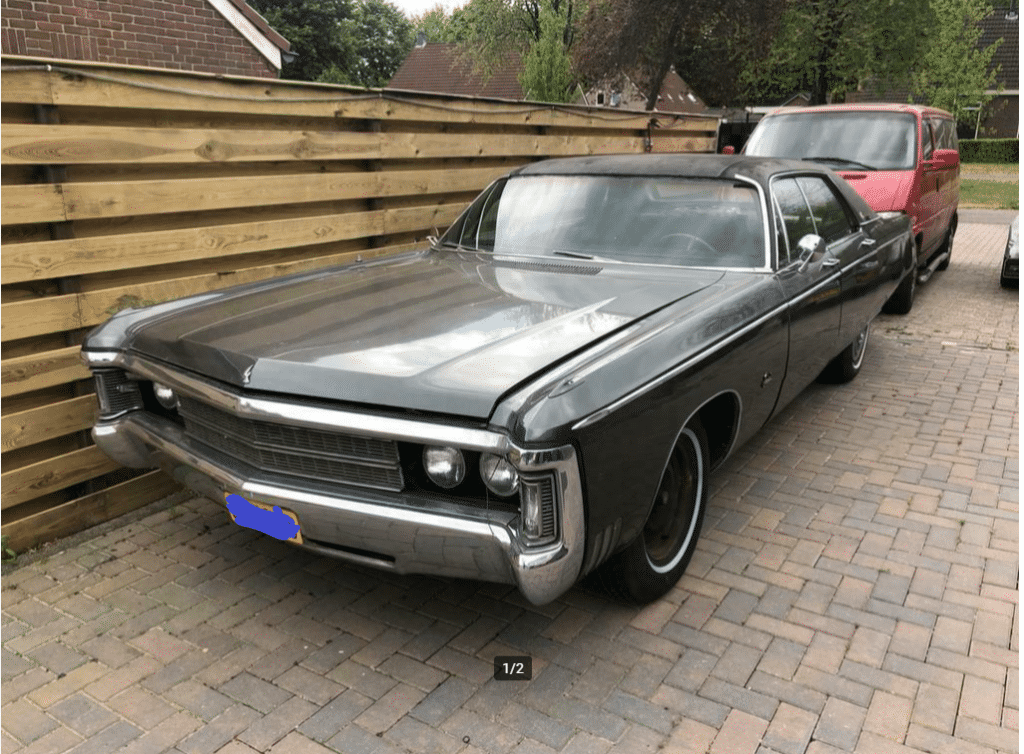

Hello everybody im a dutch dude who impulsively bought a 69 Lebaron last year and had no time to work on it till now. My friends call me Kenny.
Ive always wanted a classic american car, always bugged my parents to buy one as a family car when i was a kid. You dont see alot of them here in Europa unfortunately.
When i got older and had some money i started looking for my own, didnt care if it was a project or not, it would only add to the experience.
So I saw this car on one of the websites i regularly check for interesting finds. I'd never seen a car like this one before (still havent seen one listed after i bought it).
it was a bit out of my price range but it did catch my eye. I kept an eye out, checked the website for some other potential cars and then it happend.
The car got halved in price...
I just had to have it, instantly messaged the guy and met him the next day. We discussed the price but it really didnt matter cause i was gonna buy it anyway and he clearly wanted it gone.
Drove it home the same day with a small incident i will get into later. I now had the only 69 Imperial in my country.
then it stood there, in my backyard, sitting in the shed waiting for that TLC.
I'm 21 years old atm. I have little to no knowledge about this kind of stuff. I got no experience but i really wanna learn and am very excited to start on my project.
I dont care if it takes years. i think part of owning a car like this is to preserve it, so others can see and experience it.
Theres just something about those old american cars, No limits, just pure drivable pieces of art.
So whats wrong with the thing?
Well first of all the battery won't charge. So when we drove it home (it was about an hour drive) the car just stopped working. so we had to wait on the side of the highway till help arrived.
They recharged the battery and we drove home without any issues.
Secondly, everything electric inside does not work, i dont know if its just not connected or if its compeletly broken. The power seats do not move and neither do the windows.
The lamps do work tho, even the ones inside (dashboard has this cool green glow to it which i hope is not radioactive). The headlamp covers do not work however.
The interior is also kind of busted, im missing the entire headliner including the light if it was once there. AC and Heater also not working. Could all these things not working be part of the same issue?
and last but not least, i got a crack in the windshield. its not that bad, you can clearly see through it but it would be nice to have a new one ofcourse.
1 question: How difficult is this car as a starting project? Parts, things like steering wheels, seem pretty hard to find.
So thats basically the whole story, really looking forward to messaging people and getting to know some of you.
If you guys have some tips n tricks, like on where to start etc. and/or parts i would love to know. THANKS!

The '69 Imps are (to my eyes) the best-looking post-1960 Imperials. Yours looks stunning (is the paint code a rare A9 -- see the fender code?).
The bad news (sorry...) is that they are complex cars and not always easy to restore. If you can post a photo of your car's fender tag and a pic of the engine bay, we can tell you more things. I sincerely hope that you have one of the few '69 Imps without the H53 AutoTemp A/C, as the H51 is eminently fixable but the H53 is a pain (as @saforwardlook will tell you).

First of all, congratulations to your fine, new Imperial!
The electrical problems on these Imperials are unfortunately easily a thread of its own. A lot of weird, overly complicated stuff in them. I'm pretty sure we will get to this on this thread sooner then later. There are a bunch of pretty good, knowledgeable guys on here!
Is it a good car to start the hobby?
Well, there are certainly easier cars to start with. Ones you can easier get parts for and have less faulty electrical systems...
Every "Imperial only" part is not available in the after market so you have to find used or NOS parts which are usually expensive...
BUT the beauty of the '69 Imperial does make all this worth it anyway, but some people would call me partisan on this... ;)
Windshields are available new from a company in Finland. Kuttilan Autolasi Oy.
There is a German distributor who delivers them as well, but I'm not sure if he delivers to the Netherlands as well.
You mentioned the steering wheel. There is usually nothing on the market in good shape, but you can get yours recast. But that's VERY expensive... Mine is at D&D Automobilia for recasting at the moment. He has a 12-14 month waiting list.. ;)
There is alao "TheSteeringWheelGuy", he is less expensive, but does not recast steering wheels. He is laminates them. They look gorgeous after he is done with them, but they are not translucent anymore when he is done.
"Less expensive" in this context means ~$1500 compared to ~$2200 for recasting at D&D...
As mentioned before, the ATC AC system is usually yunk because of numerous parts in this overly complicated system that stopped working long time ago and is usually not worth fixing... I've retrofit a modern Vintage Air system in my car but had to modify the firewall for it to fit properly unter the dashboard... So that's nothing for a driving restoration like yours.
But honestly, it's usually not that hot in Europe, at least not for long, that you will be fine with just rolling down the windows (after fixing them ;) ) and enjoy the car with no AC! The heater is usually still working, even with the broken ATC.
Feel free to contact me if you have any aditional questions. I will do my best to answer them!
Good luck with your project, it's an exciting one!
