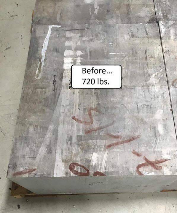

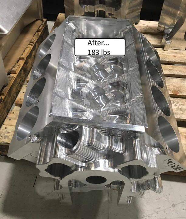

Veteran drag racer Alan Johnson (Top Fuel) manufactures his own Hemi race blocks. He uses them in Top Fuel (nitro) & Pro Funny car. As well as sells them to other teams & to Top Alcohol cars. He starts off with a chunk of aluminum & machines it down to a 426 Hemi style block.
He posted this on Facebook & made a joke about how to turn 720 pounds of aluminum into 500 pounds of aluminum shavings

A bare 440 block weighs about 240 lbs so you are saving about 60lbs, that you can save in easier ways, inlet manifold, headers, aluminum heads, aluminum water pump and housing. That will save more than 60lbs for a fraction of the cost. Its nice to dream, but the practicality isnt there.

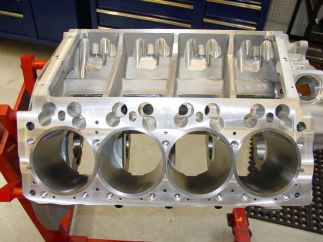

These block are WAY WAY WAY stronger than any iron block. Raised cam. Bigger cam journals with rollerized oiling provisions. Wider crank saddles for stroke & oiling considerations. Iron cracks under stress. Aluminum bends & survives the round. Much easier to repair these blocks when damaged. Many after a few races are sold to sportsman racers even after being windowed.

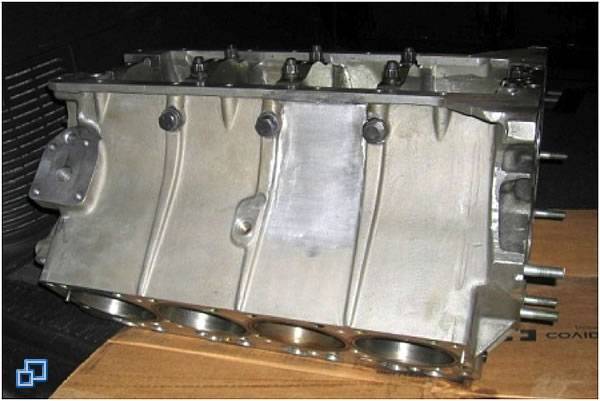

Stan Garlits used KB's & the JP1's. He even endorsed the JP1. I imagin he used the Donavan at one time too. It was an aluminum 392 with 417 inches

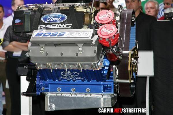

I believe this is the Ford 426/500 inch Gen II Hemi block. Yes Ford. Back when they where sponsoring John Focre they had their own blocks cast & made some minor changes to them. Basically so they could now say it was a Ford design. They called it the BOSS 500 engine. They basically copied the KB block

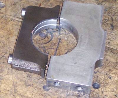

This is a stock factory style RB main cap & a KB alumninun cap. The KB cap is stronger, wider, taller & thicker. All of this has its reason. And it's cross bolted too
