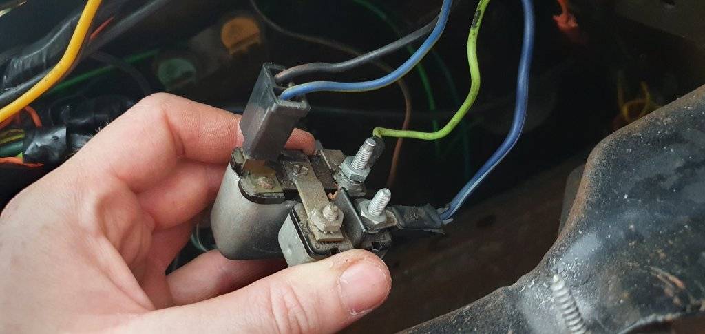

T! Would you happen to have a picture of where it will be located. As you know, my dash is 1 million pieces at the moment, and since I’m having the same issue, I can swap mine out while having access.
Well John, as marko pointed out, there appear to be more differences in the wiring from '75 Imp to '76-'78 NY than I thought so someone else might be better at pointing you towards its location. But here's an older pic of what the thing looked like on mine, near the A pillar.
