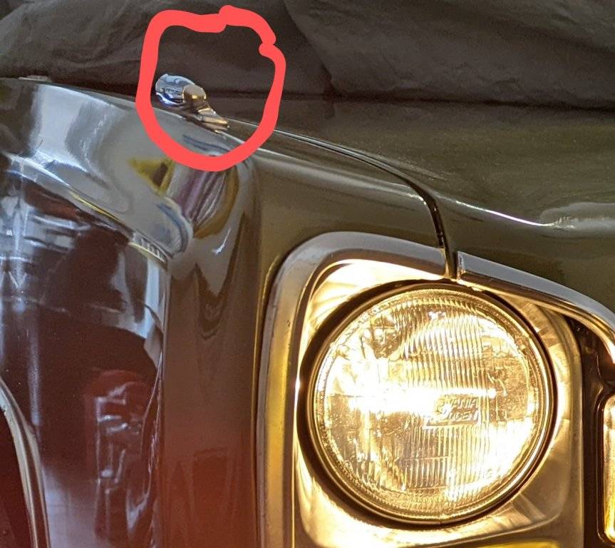

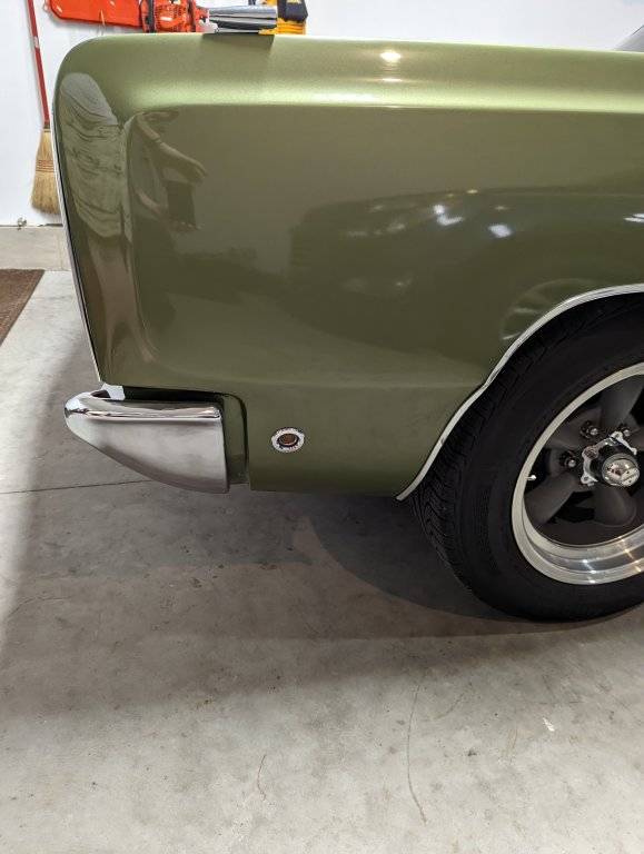

Oh, is that what these are?

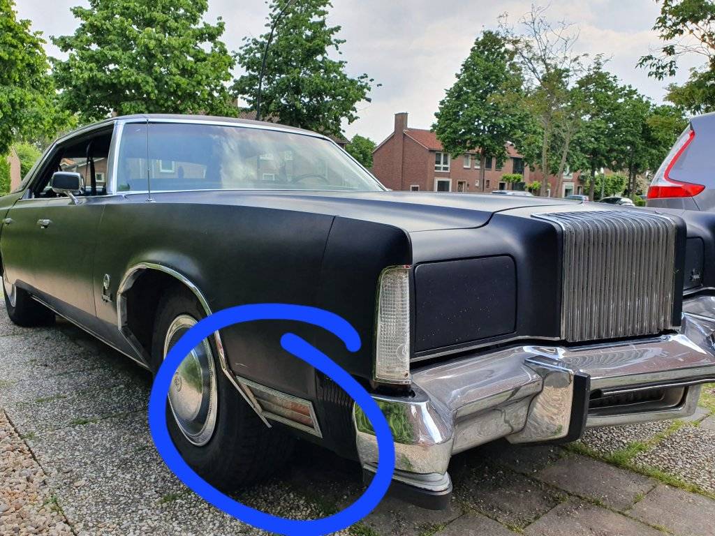

No those are fender mounted turn signals. Cornering lights are mounted at the bottom of the fender:
Nope, those are fender top turn signal indicators. NOT cornering lamps.
Cornering lamps were large housings that sat at the bottom of the front fenders, and lit up when the turn signal was activated for each particular side. They sent a wide non-focussed flood of light towards the corner of the vehicle that the turn signal was indicating.

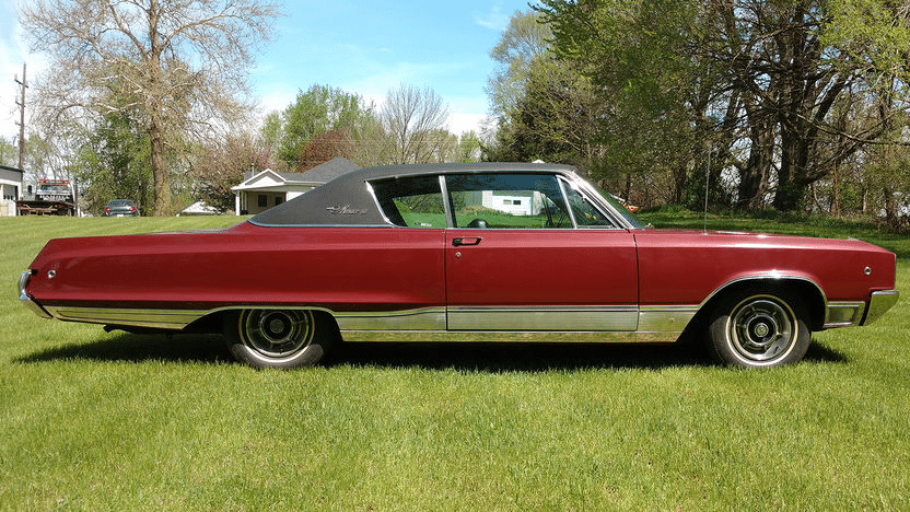

Here is a 68 Monaco with cornering lamps - look at the front fender in front of the wheel opening, in the lower trim.
For what it's worth, I don't think the Plymouth had the cornering lamp option, except MAYBE the VIP. However, the switches would all be the same between Dodge and Plymouth, so hence the listing for cornering lamps.
Thanks guys. That Monaco looks the same as mine though but higher, is that correct or no?
