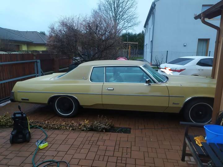

Dear Chrysler Enthusiasist,
CBODY67 and halifaxhops thank you so much for all of your responses you provided me here. I can show you now picture of our Newport. Just arrived back from the shop where they were able to do conversion with proform kit, Eddie 1406, new spark plugs, wires, new/redone calipers, rotors, pads, front bearings, brake fluid, oil and maybe something else :-) I hope now all will be running as it should and we can add more milages to original 55k when spring is here.​
thank you so much one more time, appreciate it
