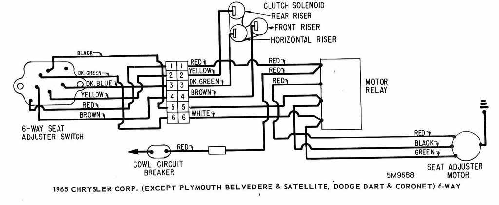

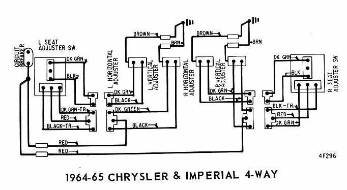

Does anyone have a wiring diagram for a 2 way power seat, 65 Chrysler 300?
Technically there's no two way power seat as each direction counts as 2 ways -
There are two versions:
6 way
(1 up 2 down 3 forward 4 backward 5 tilt forward 6 tilt rearward)
OR
4 way (1 up 2 down 3 forward 4 backward)
6 way
OR
Thanks. A lot easier to read. Trouble shooting. Gleaned all connections. Verified I have power. Now I need to make sure the seat has a good ground.
