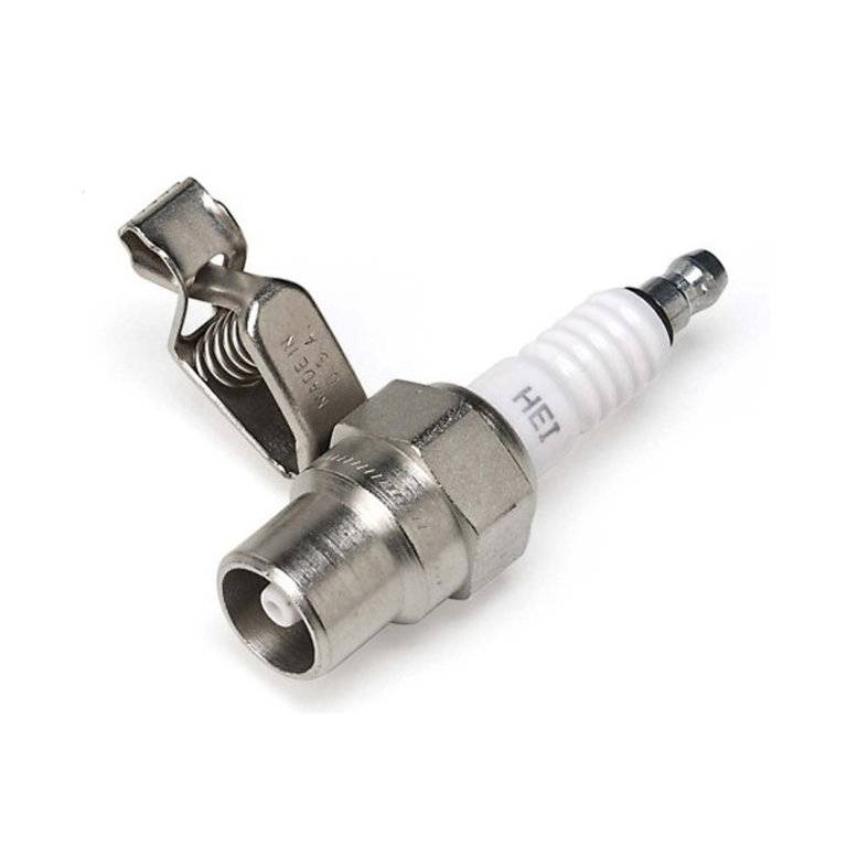

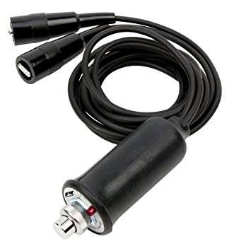

Well you have fire going to the distributor. I have the scar to prove it. At least under the start phase. Do you have one of those plug wire testers. Quickly shows if spark is getting to the plug.
Haven't seen on of these before, I normally lay the spark plug against the manifold to look for spark.
This tester you only need to remove the wire. Clip it to ground. Turn switch to on position. Use remote starter so you can see the tester easier
