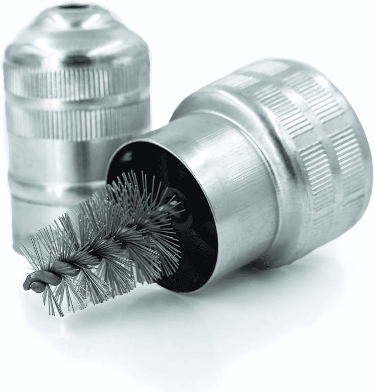

These brushes are under $10 and belong in everyone's toolbox.

Used one of the wire brush cleaners, as pictured, on the inside of the factory cable ends and also on the battery posts. Suddenly, all was well again!
