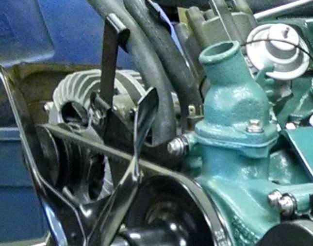

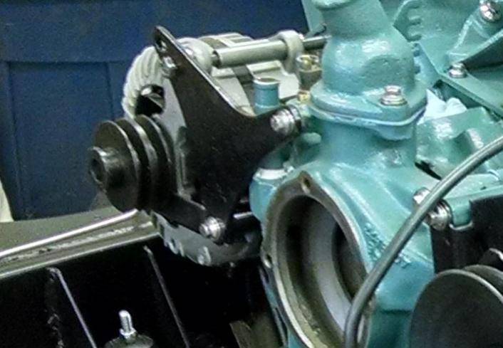

Here are a couple of details. I think you need 3 parts, the big solid triangular bracket, the alternator adjustment bracket (straight piece) and the heater hose supporter.
Another perspective. The straight adjustment bracket its not attached in the photo above, the alternator is just resting on it.bracket details.jpg
Ok, thanks.
What I do need to see is what is behind the Alternator. I think I am just missing a few pieces to make it work.

Yep, I'm missing the spacers. That would be why I wasn't able to make it work. Any Idea on where to find them?
Thanks
