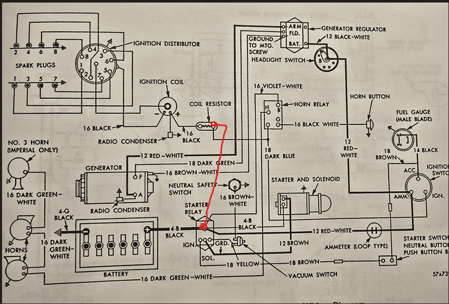

So, I'm beginning to wonder if the problem is in the ignition switch or the wire to the ignition switch itself. To test this, I was thinking on running a temporary wire from the ballast resistor to the starter relay to bypass the ignition switch. I'm not sure if this alright to do. Also, would it be best to connect to the positive wire connection on the starter relay to the battery, or connect to the IGN. point on the starter relay? I'm guessing I wouldn't be able to stop the engine after starting it without removing the wire.
This does sound like an ignition related issue.
Do you have an ohm meter you could use to test the ballast resistor? You could also get a new one. They're not real expensive and never a bad idea having a spare in your trunk if you plan to stay with your current setup.
