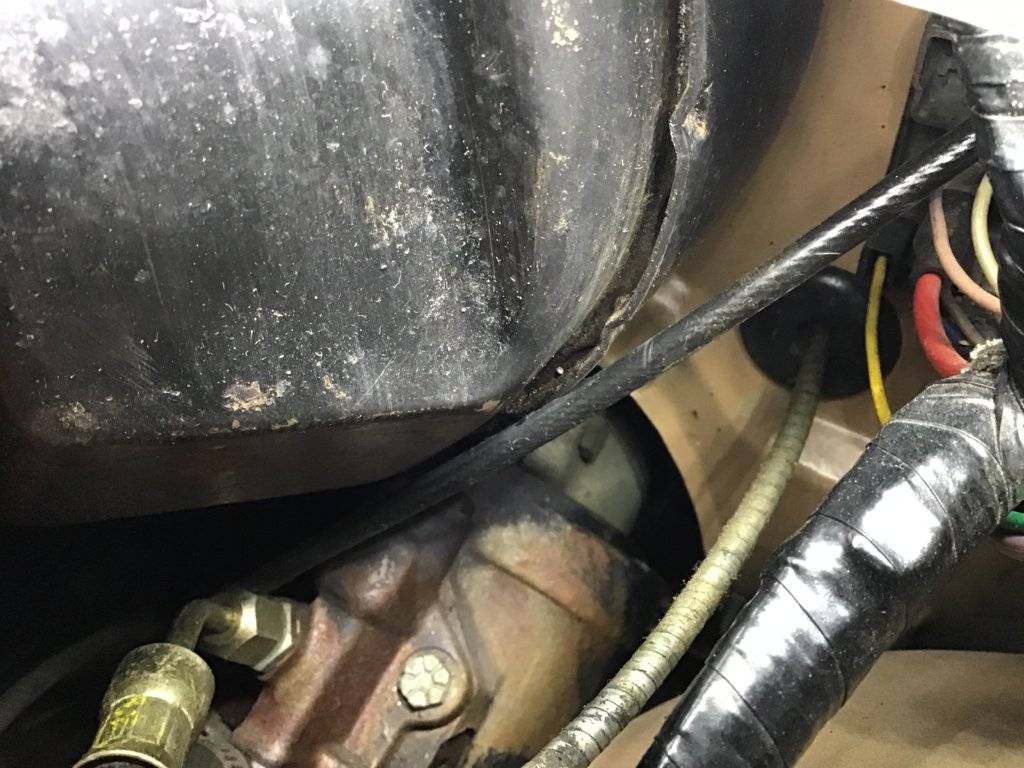

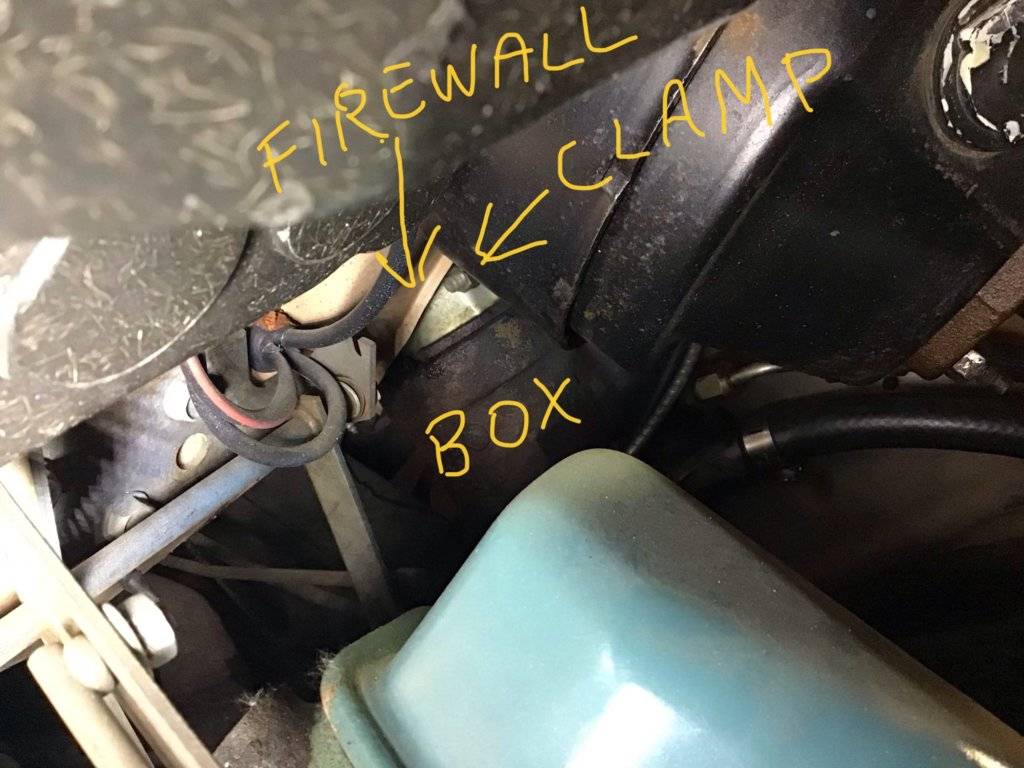

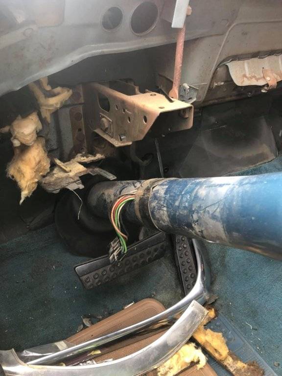

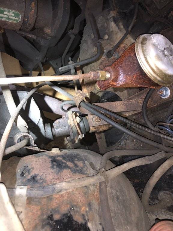

Well a Chrysler is different than Plymouth and Dodge then. The column physically clamped to the steering box. You can not see the steering shaft, The is literally no room for any column shift parts there.
Here are 2 pictures of my 62 Chrysler 300. See the tan firewall, the silver clamp with a bolt through it, then the dark is the box.

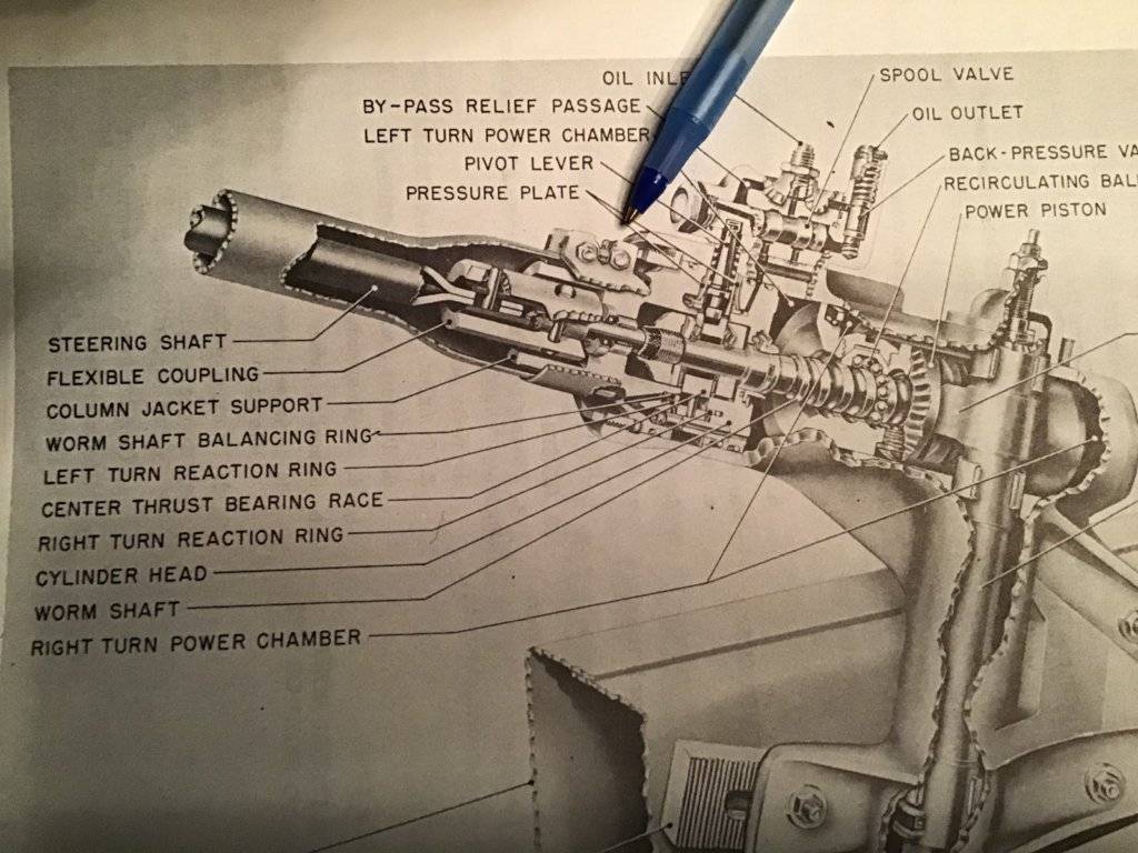

and a diagram from the FSM showing the column clamped to the box.
That’s because you are trying to compare a power steering/automatic column to a manual shift column.

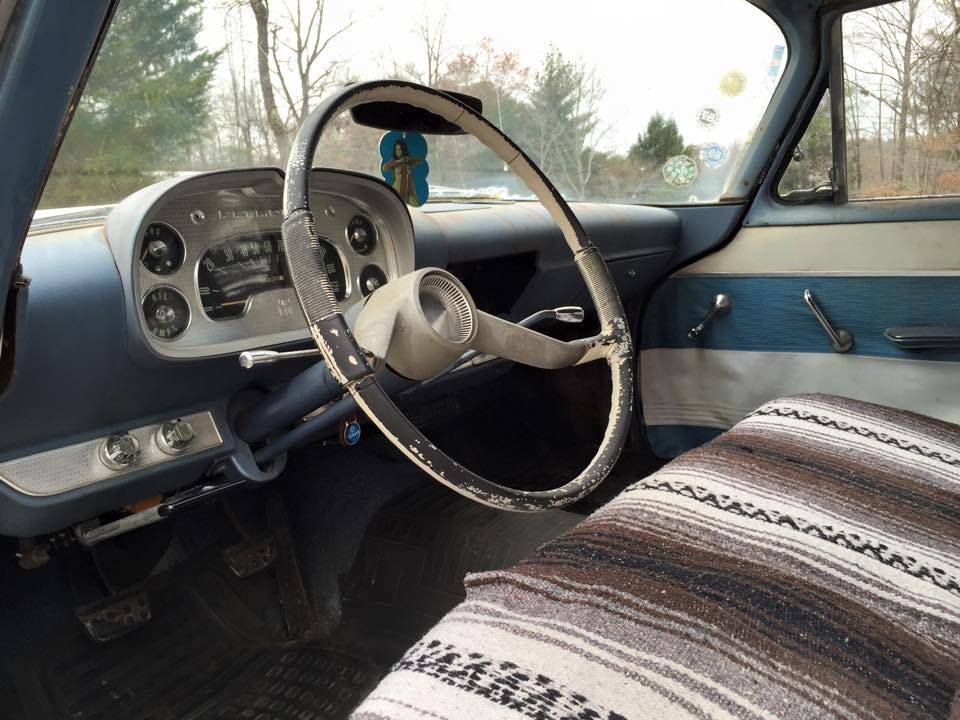

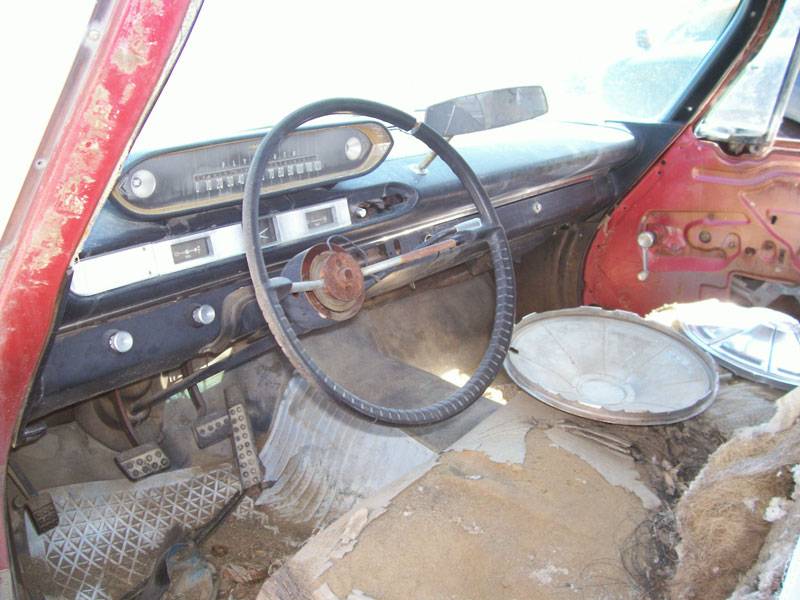

Here’s a ‘58 Plymouth I owned with a manual shift. Note the column jacket is not there and you can clearly see the shift lever/shaft underneath the steering shaft. The linkage under the hood takes up hardly any space.

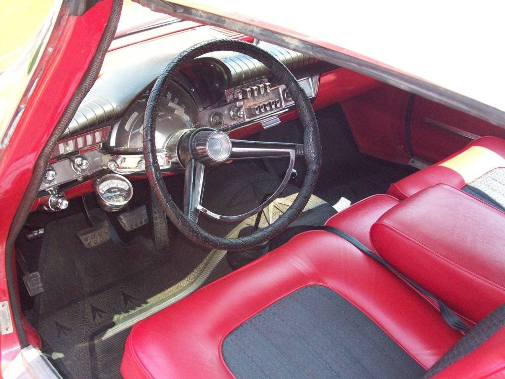

yes, my '62 300 has manual steering with three speed stick shift on the floor as I posted the interior picture earlier in this post. Also I did get the punch card and info from Chrysler Historical services and confirmed the car came as it currently is.

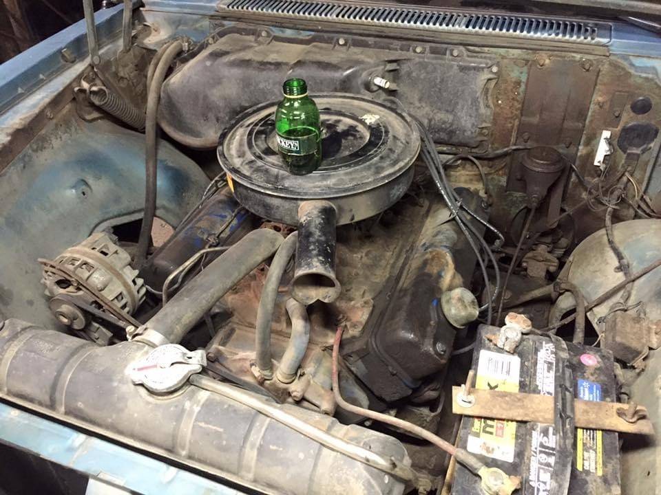

I walked out and snapped a photo of my 1961 Dodge to show you how much room is under the hood. This is a manual steering car. Note the LARGE opening that could also fit a power steering box. The firewalls and basic body structure is pretty much the same for 1960-1964 full size MoPars. The trans hump is smaller starting in 1962 due to the narrower A727 and 1962 factory seatbelt anchors were in the floors.

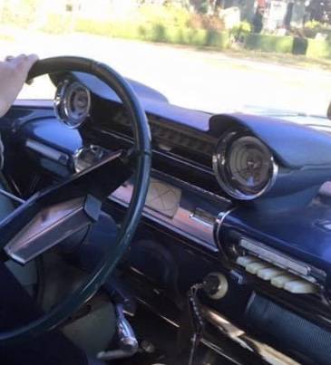

My old ‘61 Plymouth. Manual shift. Even had the same shift knob as the supposedly totally different 1958 Plymouth.
