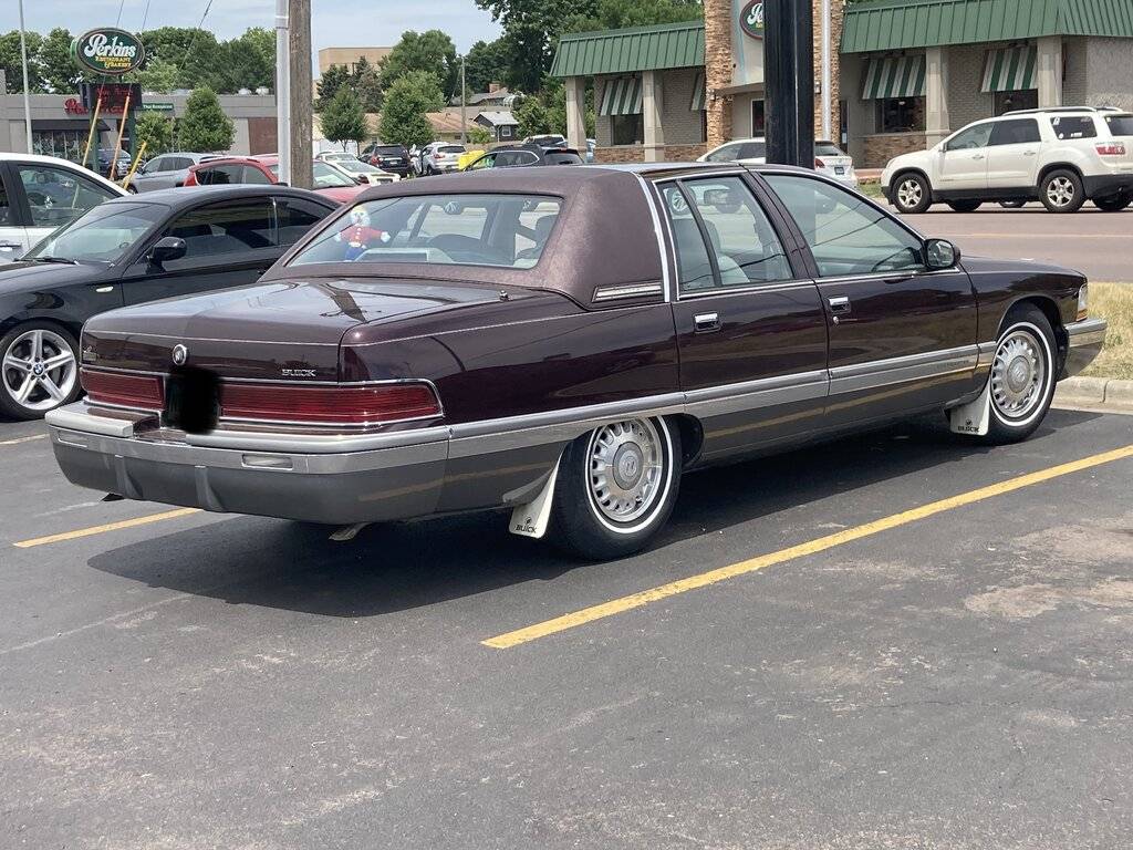

Looking for recommendations on an OBD-1 scanner for the new to me 95 Buick Roadmaster Limited.
Just had a new set of tires put on it and once in a while, the service engine soon light comes on (and disappears a few minutes later).
I put 5 Hankook H724s on it and they made a great improvement.
Yes, that’s Mr. Bill in the rear window.
