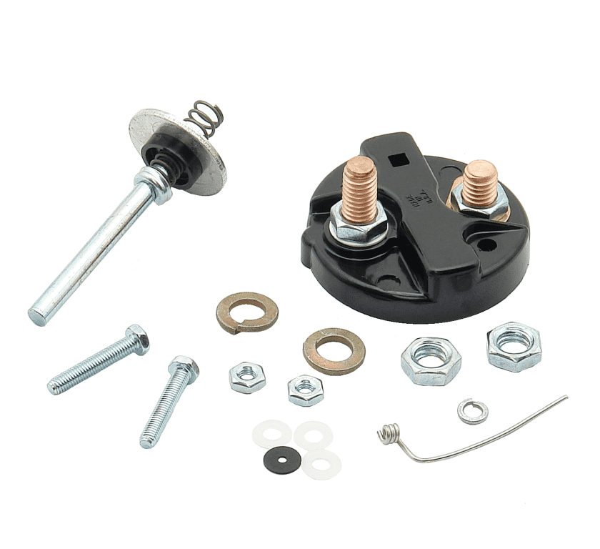

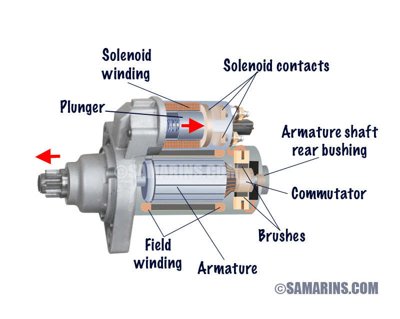

It also sounds like the starter solenoid on the starter migh be pitted. Let me find a picture it is a disk that goes in and out to activate the starter motor.
Battery has to be properly load tested, even brand new one can be junk, I've been there.
If you've got these troubles at normal battery voltages, the trouble would be in the solenoid contacts that are usually quite fried mostly on account of weak/dying battery issues.
A dying battery = lower volts while cranking = higher amperage across the contacts for a given wattage, which eventually destroys the solenoid contacts to the point that they melt together causing endless starter runaway that can only be cured by disconnecting the battery.

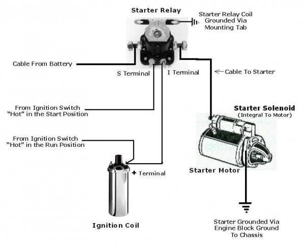

Why the Ford solenoid?
Avoid the noid? ;]
Ford has a fender mounted solenoid - I also worked at a starter/alternator rebuilding shop for 2 years as "light duty" on my out of professional repair work - because it doesn't have one on the starter.
There's no foreseeable reason to have one used in conjunction with the Chrysler gear reduction starter, or the older Mopar - made by Autolite - unit with round solenoid on top with unique rubber boot that were typically still used on Wideblocks and on truck applications until much later than the ploy to end the poly.

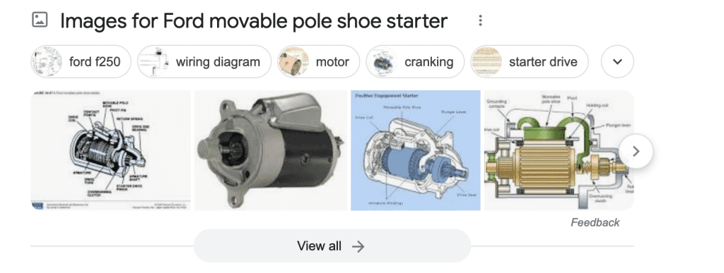

Back to the Ford, a very weird starter... (Ford = just not for me, the sanitized version), in fact unique as far as starters go but it's interesting to note no one has copied it, while all Japanese starters are miniaturized version of a Chrysler Gear Reduction starter, unveiled in 1962, another Chrysler 1st in a long line of Chrsyler 1st's, the 12V stystem alternator in 1960, while "more better" Chevys went on to have a generator for several more years.

If you're using a Ford solenoid instead of the Chrysler starter relay, it would work fine, otherwise it could be your problem, using the extra solenoid.
Thanks guys! The Ford solenoid is connected to the positive terminal on the Chrysler starter. From what you guys said, this maybe the reason for this weird problem? (see pic). I went thru 3 mopar starters in 5yrs. Had it with not starting when hot, so I put a Ford solenoid on the fender and never had that hot starting problem again. That was 10yrs ago.
But from what you guys said, I guess the problem is that the Ford solenoid has to go thru the crappy Chrysler solenoid which burns out prematurely due to its located an inch from the heat of the engine (a poor design). So if I totally remove the Chrysler solenoid and wire it directly, it should fix this problem, correct? Thanks for your help!
