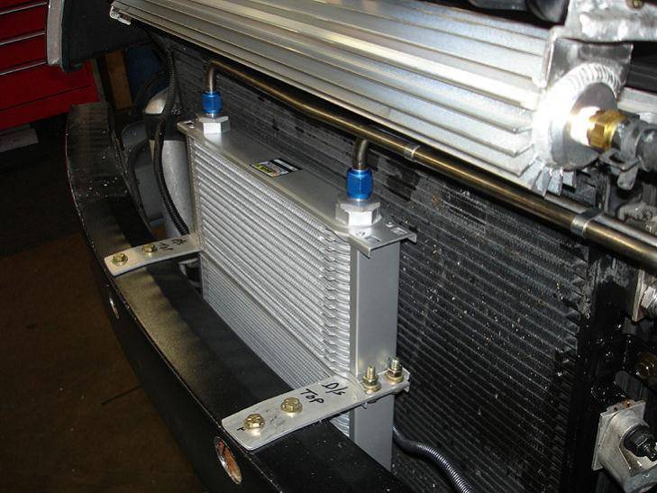

I run Coolers on my Trans and Engine Oil. It's nice to see the Gages reading temps on totally isolated systems it also makes diagnosing temp problems that much easier. Remember an Engine Is a Heat Pump you need to run at least 195 Thermostat. I'm running 210 and can drop my heat soak With Auxiliary Electric Fan unit for Car show cruises.
