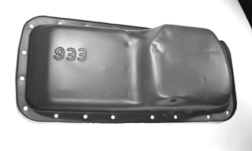

Shown above is an original factory USED "933" oil pan, Chrysler part number 3751934. In general, this pan was used from 1974 until the end of production on "C" body cars with high performance 400's and 440's.
There was a 400/440 hi-po pan 3751934 and it was STAMPED 933. It had a baffle as oppose the the standard pans.

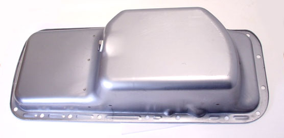

Here is a 6 qt oil pan that was the Hemi oil pan. It won't fit.
I have several 933 oil pans with and with out baffels. Will the pan from the 70 to 71 c-body work?
