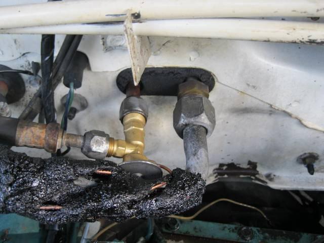

So I had my A/C fixed a while back, or so I thought. I replaced the comp, the dryer and expansion valve, and swapped the seals out for the R134a. I only drove it down the street taking the guys word that it was good, and I parked it. So the other day I go to take a short drive and its got nothing, no cold at all. I call the guy and tell him what I got, he says bring it back, which I did, and after 2 days and another expansion valve and some "bear crap" to insulate it he discovers that only one line through the fire wall is cold, REAL cold, the other is not. He said there must be a restriction in there. I cant even say the name of the part now, duh. Lol Anyway, anyone ever have this or know whats up with this? The system has been closed the whole time I've owned it, it just had a bad comp. Is there a valve in there somewhere that it at fault or is this a plugged up...um...still cant say the name dammit, you know that little radiator looking thing that looks like a heater core. Lol. In the pic the small line with the new expansion valve is the cold one.
Evaporator............

Thanks. Well, I someone else told me that one hot and one cold is right, but according to him, the LARGER line should be cold and the SMALL line hot....which is opposite of what I have. Not sure how that can be since the lines can only go on one way and the compressor can only turn in one direction??? $%@#$ I hate this kinda $^$@#$&!!!!!!!!!!!!!!!!!
Well I talked to the tech that was working on it to find out what the high and low side pressures were, he said the high side was about 150 and the low side was about 60. He said the high side should be in the 200-250ish range and that's why he thinks there is a blockage. Does this sound right to anyone here?
If there is a blockage in the evap, you would think your high side, leaving the compressor would be 200psi plus, and you would almost go into a vacuum on the low side.
I misquoted the guy that's been working on it, he said what you are saying, and another local tech I spoke with also agreed that IF there was a blockage the peruse on high side would be excessive and a vacuum on the low side. Oh yes, my guy that I have been using also said he checked out the blend door and made sure all the "visible" and checkable vac lines were in proper order and all seemed ok there, so guys, whats left? New comp, new dryer, new expan valve, no blockage, what else might cause low pressure readings and no cold air? Thanks for any ideas.

low side should be about 30, high side is ok at 150. I dont believe there is a blockage, with low side at 60 it wont cool, you may want to find another a/c tech
