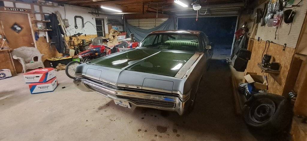

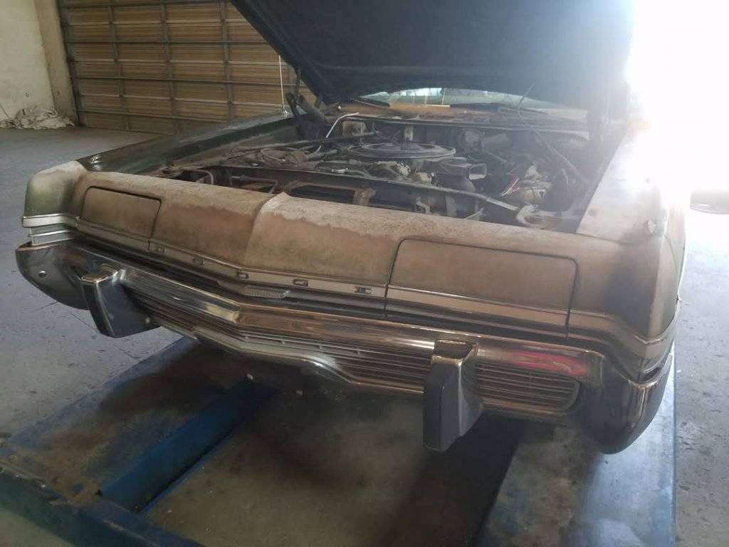

I've been curious on what everyone uses for O.D transmission in a 73 Dodge Monaco.. it is a big block car. Anyone find a good viable option without having to rebuild the whole car.. if my car was a usual no floor rust beast I'd chassis swap a SRT Charger.. but mines solid and would love to keep the 400 or a hopped up U code 440.
