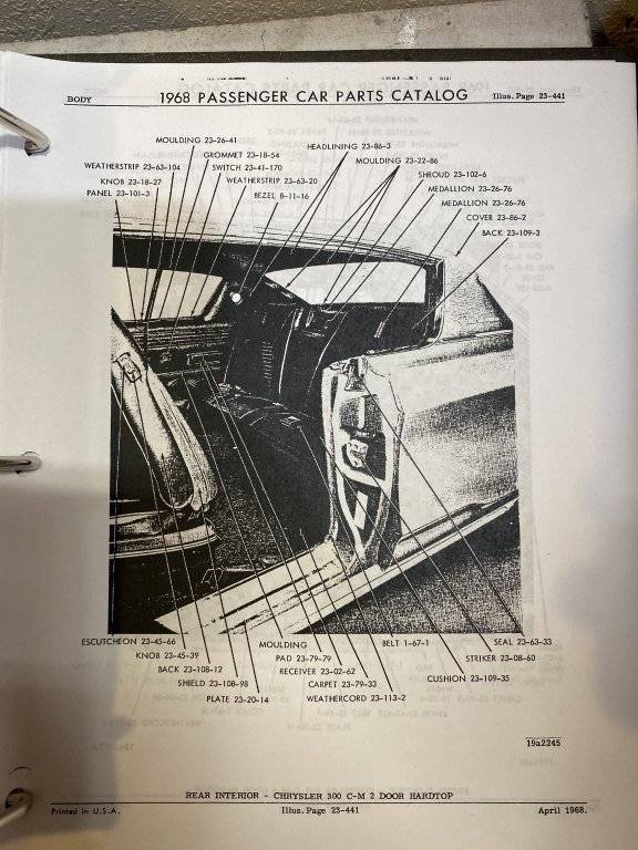

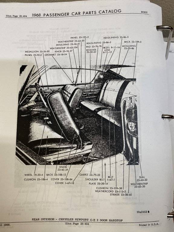

I need to check the part’s books but I believe the Newport had a full rear seat back but the 300’s had the rear seat back that dropped down like the convertibles.
So the seat back is different but looks like it shares the same package tray.
Here’s the PN.
CE is Newport, CM is 300
