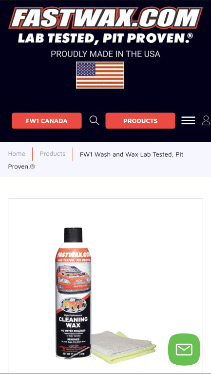

You know spring is here when these guys show up at the gas station's. It's actually a really good product. It's not going to be as good as the multi-step methods listed above. However it's very quick and easy. Spray everything including glass, rub majority off/in, then go around polishing. Done. Makes black plastic on newer vehicles darker, doesn't cloud windows when it gets wet, actually works like rainx, beads nicely for quite awhile, polishes and protects chrome, sort of works as tire shine, helps keep brake dust from sticking to wheels. The girl that approached me at the pumps a week ago claimed that it would take the yellow out of headlight plastic. I think that's a stretching the truth, but I could be wrong. A little goes a long way, the first time I used it I layed it on really thick which was a waste of product and time.
FW1 Wash and Wax Lab Tested, Pit Proven.® — FASTWAX
