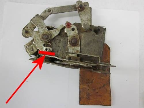

Ok, here are some pictures that might better help.
First is it locked...
If it is unlocked then you need to see if you can move the release lever...
Even if you move the release lever you may not here a click or have the door open. This doesn't mean that it will not open, (this is where having the linkage hooked up comes in) hold the handle open (you may need to do this at the mechanism first, if it is stuck the rods just bend) and try and force the door open.
Basically moving the release lever may disengage the latch but if it is stuck it will not spring freely but with the release lever open there is nothing keeping the latch from moving. The spring may be broken or it is just gunked up like mine was. At the end of the day it will open if you can move these levers.
