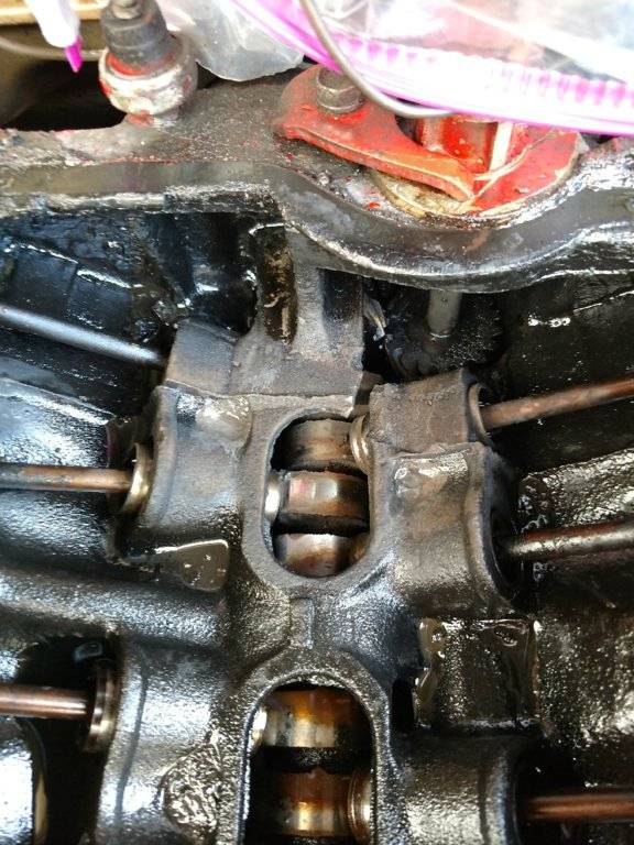

I've run into another potential issue...I just pulled the intake and (aside from the current cam looking pretty worn, I see what looks like a big crack in the lifter valley just forward of the distributor??!! Pic attached...is that supposed to be there???...

Well that just sucks more than I can find words to describe...Wow....just wow.

You have a date code correct Car. Vin numbers on the block didn’t start till mid 68. So you can find a date close to the date on yours. Switching to a big block is a bit of work.
If you're referring to the poor quality of the molding of the block, where there is a lack of a bridge between the left and right bank of the lifter bores, that's just Chrysler for you. Here's some examples, nothing wrong.
There's nothing wrong with your block. It's been running fine with that since it was born.
Wow man...that's shocking. Is there any way I can tell that this is the case with my engine too?...the edges on my "space" in the valley seems quite jagged which led me and others to believe that a lifter must have stuck at some point and caused the crack. Some of the pictures you posted made the gap look more smoothed on the edges like the molten metal just didn't meet in the mold upon casting. If it is remotely possible this is a normal situation, I'll continue pulling it apart to complete my original project...many thanks to all who have assisted me with this from afar!

Whomever thinks a lifter sticking did that doesn't know how cast iron behaves. If a lifter had stuck (and by "stuck" I mean stopped dead during a running event where some inertial energy could be present) the lifter bore would have fractured. Not a little connector piece well outside the bore. That's an area that probably was cast solid but during original machining fractured and broke out. If you're that nervous look in the oil pan. If it's in there it broke while you were running it and it's been in there for decades. If it's not, it broke prior to assembly. Either way no harm no foul.
These cars were designed to last the payment book. The work was production line which means some were great, most were average, and others were horrible...

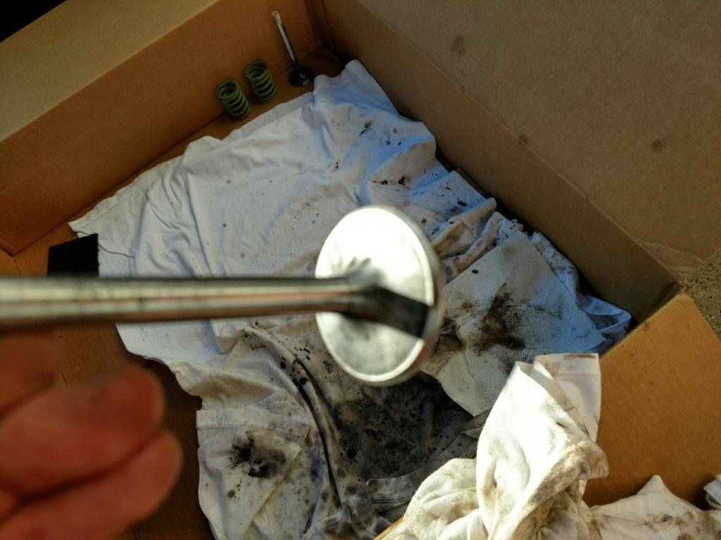

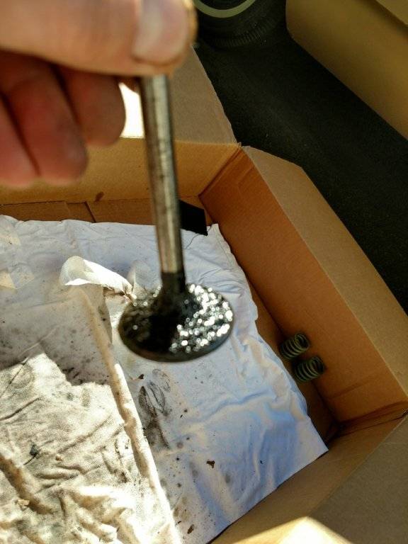

Alright, it's balls to the wall on my project!...decided since the heads were a little gunked up I'm pulling them, stripping them down and cleaning them. Going to lap the valves too since I'm in this deep already. Going with new stem seals, springs and lifters. Next, the perf cam and new timing chain goes in. Hopefully at some point I'll actually get to installing the part that started this whole project- the 4 bbl intake and carb!...

Nope...it's the small pressed in button looking plug atop just one rocker tower on each head. It holds the rocker shaft in place. I was looking to remove each head's rocker shaft and arms and completely disassemble the heads for cleaning. I figured it out...just required patience and a little more muscle... before and after shots...
