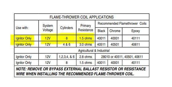

Actually the coil recommended for the kit on a V8 is 1.5ohm.
They pulled that crap on my brother and his ran like crap with a .6 coil. Bought a 1.5 coil and wired it up like stock was fixed the problem. I think Pertronix doesn't know what it's doing or talking about.
That chart isn't on the instruction sheet I have for the Pertronix Ignitor II I have in my Barracuda.
EDIT: Just looked again and that is a chart for the Flamethrower coil for the Ignitor and not for the Ignitor II that we are discussing.
The website specifies a .6 ohm Flamethrower II coil.
Ignitor II
My instruction sheet.
"0.45 Ohms or greater" 1.5 Ohm would be greater. As would the 0.6 Ohm Flamethrower II
